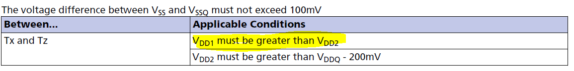

    TPS65296 has its own solution for ramp up needs of LPDDR4.
    I am looking for a solution for uncontrolled power-off scenarios for LPDDR4 device. Below picture is from Micron's LPDDR4's datasheet. So I need to keep VDD1 always greater than VDD2 even with uncontrolled power off scenarios.

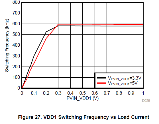

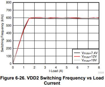

    We had discussed about my current needs are much smaller than what TPS65296 can offer. For my application, at some point, I wont even write or read from LPDDR so load current from both rails will be even less from the numbers I have shared earlier.
    So from below pictures, Switching frequency will be less than 600 for VDD2 and less than 580 kHz for VDD1 in my application.
    I used almost the same circuitry from your evaluation board.
    Would this cause a problem? For 1V8, I think more or less my circuitry needs 300 mA but for VDD2 switching frequency will be much more less than 600kHz.
    My FPGA expects 1V1 rail in between 1.06V-1.17V
    My FPGA expects 1V8 rail in between 1.746-1.854V
  • Hi, Onur,
    From power on/off timing(the picture you attached) in 65296, VDD1 always high than VDD2, not ony for ramp up but also for power down. I dont see any improper condition.
    For Frequency, it is no problem, since your current requirement is smaller, IC will enter PSM mode to save power and improve efficiency, Frequency will be reduced. it is OK.
    Yuchang
