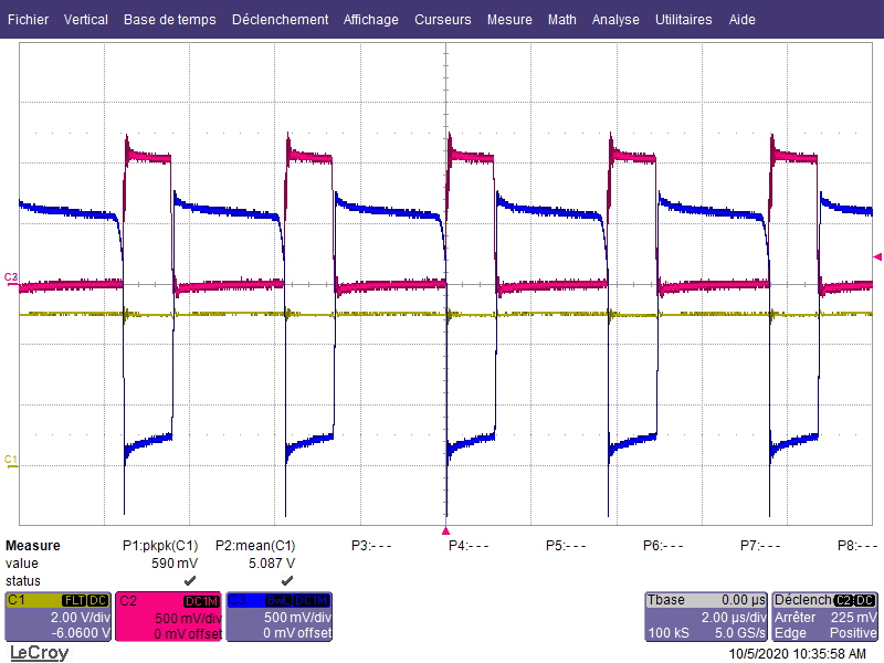

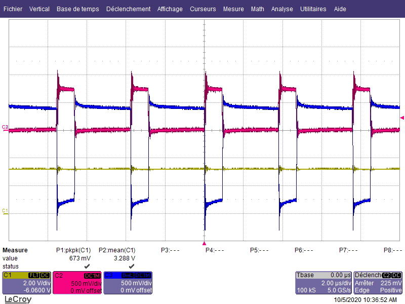

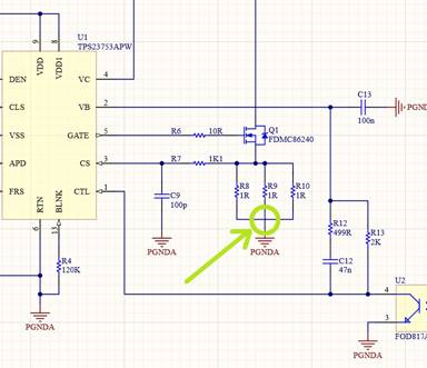

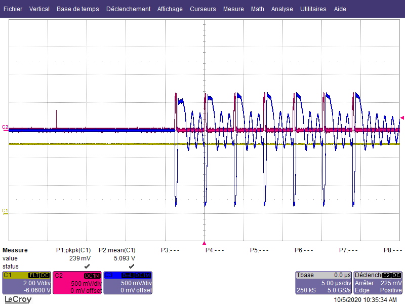

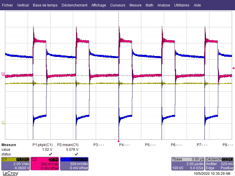

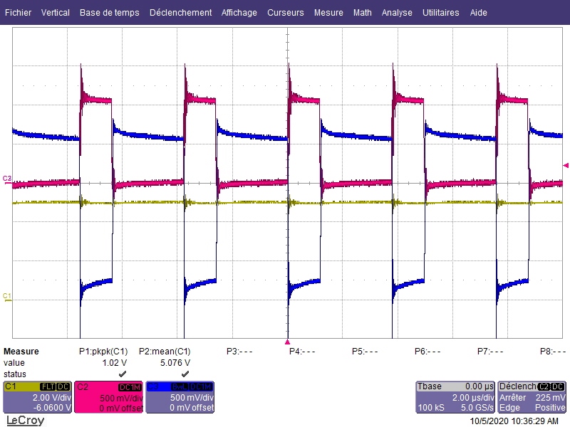

We designed a POE supply 5V / 2.3A (class 0). The schematics are attached.

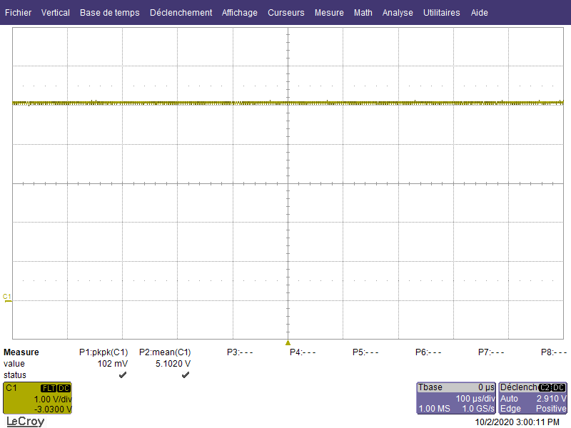

When the load is lower than 1A, the output is stable at 5V with a less or equal to 100mA => perfectly normal.

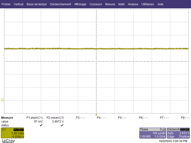

The problem is when the load is higher than 1A, the output voltage drop to 4V or less but without any instability or hudge ripple...
I compute again the components value but even with the new one, the results are the same...
Could you help us?
