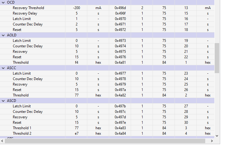

         I am facing issue in terminating the discharge process, I placed set limit of 350milli amperes for OCD1,when current flowing to load goes above 5 amperes,{ XDHG[1],DHG[0] }.After 5 seconds delay,BMS circuit is recovering,{ XDHG[0],DHG[1] },again as load is same current is going above 350milli amperes creating a infinity loop.
This cycle  is going endlessly ,so, I need your  help me to set a limit to terminate this loop.

I am attaching my log files ,.gg file
