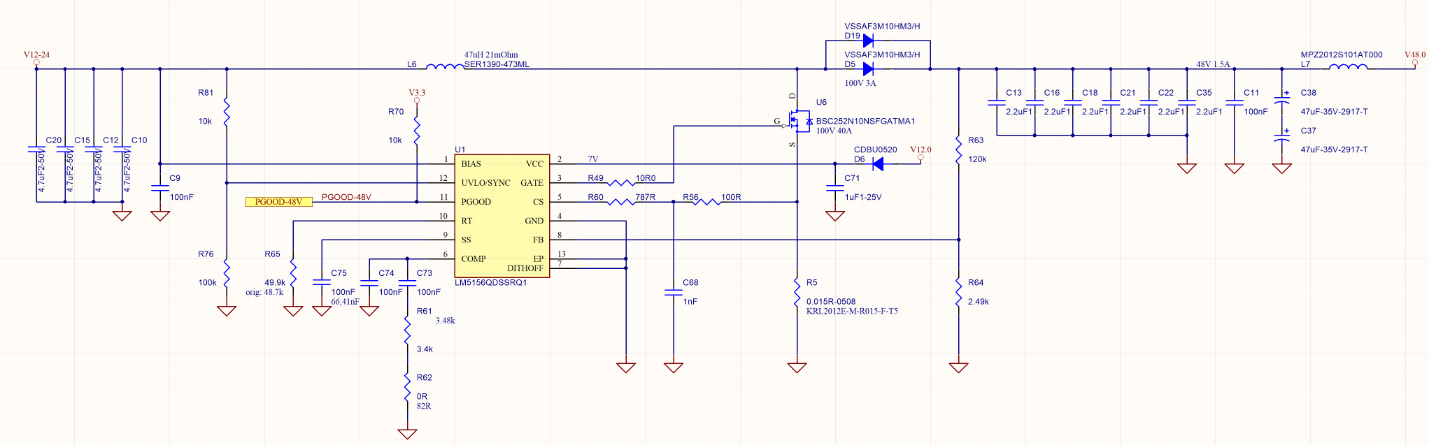

I have created the schematics with Webench and the following settings:
Vin: 12V
Vout: 48V (at 1.5A)
I have noticed that Ccomp2 capacitor is 100nF. This is expremely high. In the demo board schematics you use 22pF. I have 2 problems:
1. I only get a max current of 0.7A. At higher currents the voltages drops significantly (37V at 1A)
2. I have very high losses (approx. 30%). The heat is generated in the power magnetics and the MOSFET.
I have tried two magnetics: SER1390-103ML and SER1390-473ML. I am using the BSC252N10NSFGATMA1 MOSFET.
Can it be that the MOSFET is enabled too long - wrong timing? Is the gate charge of the MOSFET critical?
