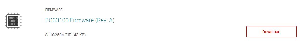

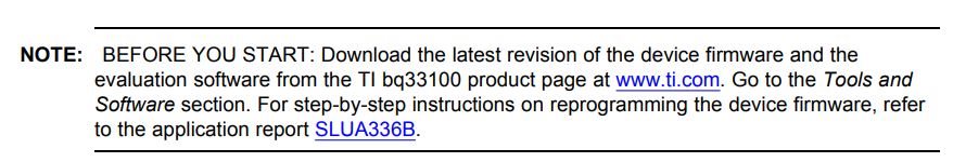

I don't have an EV2300. How do I know if the IC works? Can I use the TI original BQ33100 sample directly on the motherboard? Or do I need to burn the Firmware_SLUC250A.ZIP (43 KB) to BQ33100 that provided on the official website?
  • Hello Len,
    The gauge should ship with firmware on it, we always recommend testing with the EV2300 to debug issues quicker. The firmware on the page may be an updated version.

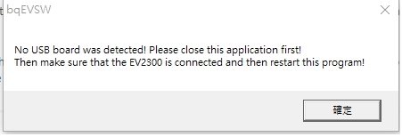

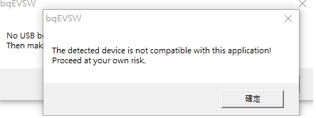

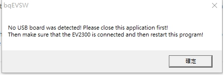

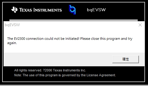

    We use EV2400 with bq Evaluation Software to debug the BQ33100. There is a problem that the BQEVSF tool cannot successfully recognize the EV2400 when using the EV2400 fixture. How can I troubleshoot this exception?
    1. BQEVSF tool cannot successfully recognize EV2400, error code: 2
    Method 1: Upgrade EV2400 FW to V0.28, which has been completed, but the error cannot be resolved.
    Method 2: Update EV2400_Support_Components_20110524.exe, which has been completed, but the error still cannot be resolved (the tool still only recognizes EV2300).
    The detailed pictures are as follows:

  • Hello Len,
    Are you running the software as administrator? I would also check to see if bqStudio can communicate with the EV2400 in case there is an issue with the EV2400 itself.
    Sincerely,
    Wyatt Keller
  • Hi Wyatt,
    I running the software as administrator can detect device, TKS.

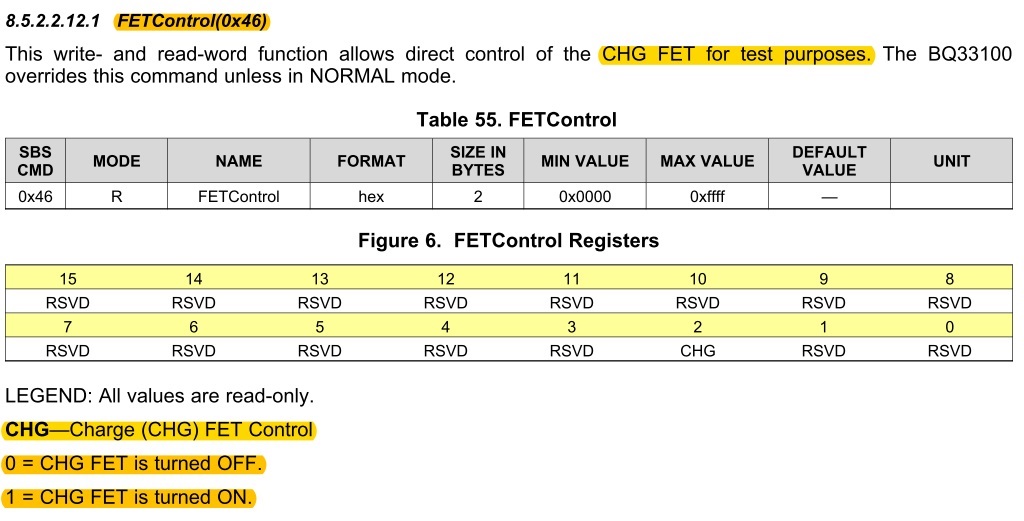

    I tried to use the FETControl (0x46) function to force the PMOS to be turned on for charging.
    The test results showed that the PMOS can be forcibly turned on, and the super capacitor is charged normally.

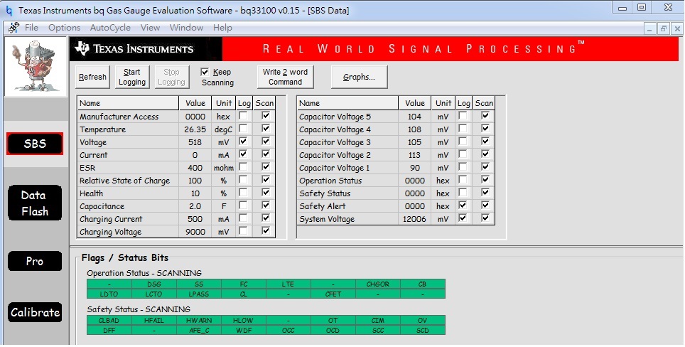

    I read the messages of SBS & Data Flash.
    According to the description in the FET ACTION chapter, if there is any abnormality in the safetystatus status, the charge FET will be turned off; but in the TI bqEVSW tool detects, the safetystatus is all green, and no detection is high.
    But, the CHG signal is always high, the PMOS cannot be automatically turned on to charge Super Cap.
    How can I adjust the firmware to make the chg function work normally??
    1.How to set the parameters to turn on PMOS normally?
    2.What conditions must be met for PMOS to turn on?

    Do you have SLUA336B technical documents?
  • Hello Len,
    You should be able to configure the FET Action register in order to use the firmware to control the FET. Check to make sure the FET control register allows for the firmware to control the FET. Set the FET to be on and then simulate a safety event to ensure the FET is turned off.
    The application note SLUA336B must've been removed from the TI.com. I was able to find a copy but it only briefly covers the firmware update.
