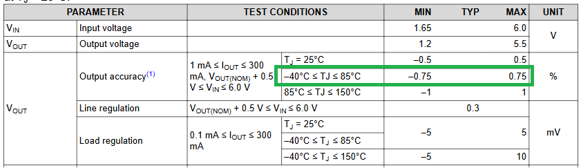

TPS784's datasheet shows a good accuracy number of 0.5% on page 6, and 1.5% on page 21. I noticed that CircuitEXP lately demonstated that TPS784 can only achieve a 5% output accuracy per their online tutorial.
It seems that, to achieve 3% accuracy, the resistance needs to be much lower for TPS784 due to the bias current variation. Could you please confirm the analysis result shown in table 8-1 in the datasheet?

    The reasoning on lowering the Vref from +/- 1.5% to +/- 0.75% comes from the electrical characteristics table.  The design example stated that the temperature was 85C max.  At a reduced temperature range the fluctuation on Vref is lower and the tolerance is improved.

    I have a last question on Vref tolerance. You showed me where the 0.5%, 0.75% and 1% tolerance for Vout are coming from. However, if you use the Vfb min/max values, (1.182V min, 1.2V typ, 1.218V max), from the datasheet, you may see 1.5% error for Vfb. Doesn't this contradict with Vout accuracy of 0.5%, 0.75%, or 1%? What is the explanation?

    I think I can resolve the issue in the application section of the datasheet.  It appears the example does not include the bias current.  If I remove that (I set it to 1pA with 1pA of tolerance) then the simulation gets us very close to 1.5% tolerance, using Vref = 0.75% tolerance.  So that is the issue there.
    The Vout accuracy of 0.5%, 0.75% and 1% does not include the feedback resistor tolerances.  See note (1) under the table. Across the entire temperature range, the Vout tolerance would be +/- 1.75% (the 0.75% is from -40C to 85C and the 1% is from 85C to 150C).   Also, I need to correct a typo from a previous reply.  I wrote that Vout would be 1.5% tolerance without feedback resistor tolerances, what I meant to write was 1.75% tolerance across temperature.  The Vout accuracy includes Vref tolerance, Line Regulation and Load Regulation which is why it is slightly higher than just the Vref tolerance alone.  In sum, Vout accuracy includes all DC components except for the tolerances due to the setpoint resistors.  So there is no contradiction.
