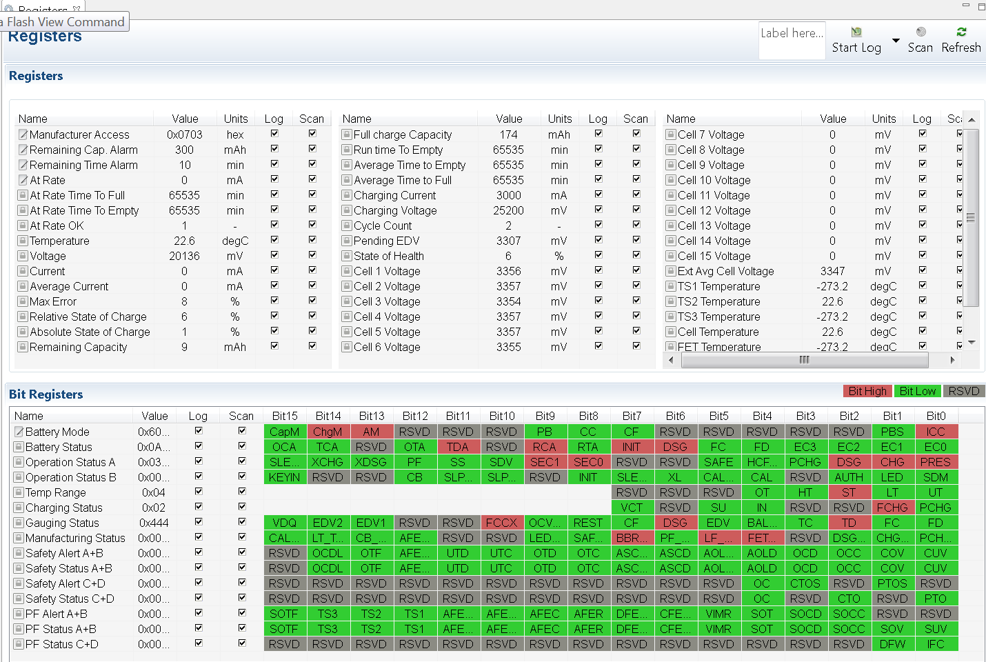

we have an issue with fuel gauge especially with the FCC parameter.
We did learning cycle. Charge -Discharge-Charge to full. The cylce where made in our devices with BQ24610RGET charger. Battery pack was checked in charge and discharge condition. Later on the Device was switched off and carried to stock. After three weeks we checked device and switched it on by battery. RSOC was decreasing very fast and steppwise. For example from 90% directly to 7%. We analysed parameters with bqstudio and figured out FCC parameter was very low. Should be arround 2700 mAh and was 174 mAh. The learn parameter was not there anymore. How can this happen?

  • Hi Ingmar,
    When you power off and power on the device, all of the device registers are cleared, so information that is not stored in data flash is lost. When the device powers on, it can only estimate the SOC based on the cell voltages (see TRM section 9.1.4 Initial Battery Capacity at Device Reset). It determines this based on the ChemID that has been loaded into the device. The process for selecting and programming the ChemID is discussed in more detail in the Gas Gauging section of this document: https://www.ti.com/lit/an/slua924/slua924.pdf An accurate ChemID will help to better estimate SOC on power-up.
    When there is a qualified discharge to the EDV2 voltage, the SOC will drop to 7% and the FCC will be updated with the new learned value. You can limit how much the FCC can change by properly setting the FCC Learn Up and FCC Learn Down limits in data flash. Currently you have both of these set very high. Normally you should set these to a much lower percentage of the Design Capacity
