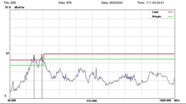

Currently our application has max current load <400mA.  For such small current load application, would there be any side effect of using LM3435?  Or there's any design concern we should consider specifically?
in parallel, we currently configure RT pin to generate a switching frequency around 500khz and got obvious EMI issue.  How should we consider to choose a propose switching frequency or how can we add filter circuit on SW node to improve this?
Thanks!

  • HI Monet,
    Regarding EMI issue, please check the result as below.  In parallel. there're some further questions.

  • Hi Antony,
    1. the increasing switching frequency will leads to the more EMI issue.
    2.if you try to increase switching frequency, a filter can be designed to eliminate high frequency signals and the size of design will be lager than before.
    3.the nominal maximum LED current is governed by the equation in below: ILEDx = 24.75/RIREFx * 10^3
    could you please tell me that what are the corresponding curves in the chart?  the EMI issue happed in which output signal?

  • Hi Monet,
    Regarding the EMI issue, they just confirm the EMI appears when the LED function is enabled.  This is checking through a EMI scanner aimed at their system.  They currently have no idea which signal(s) is directly linked to the EMI noise seen on the curve provided previously.  Do you have any specific suggestion regarding what kind of test can be performed to identify the noise source better?

  • Hi Antony,
    Would you mind tell me that for which application do you use the LM3435 and I can give more detail suggestions?
    The LM3435 integrate a synchronously rectified non-isolated Flyback converter. An external resister connected from VOUT to the RT pin sets the main MOSFET on-time, determine the switching frequency. The programmable converter switching frequency up to 1MHz, which is the initial cause of the EMI issue. Please take care of here.
    Before the EMI filter, the following steps you can have a try:
    1. the L1 and SD1 should be as close as possible to the SW pin.
    2. The PGND connection to CIN and VOUT connection to COUT should be as short and direct as possible with thick traces
    3. The inductor should connect close to the SW pin with short and thick trace to reduce the potential electromagnetic interference.
    If the EMI issue affect the LED circuit output, a filter is useful. If the EMI issue affect the other circuit part, a shield is better.
    According to your design requirements, choose the suitable frequency balance the EMI issue and power efficiency.
    In addition, according to your description, I think LM3549 is also a suitable LED driver, which is more cheaper and easy to use.
