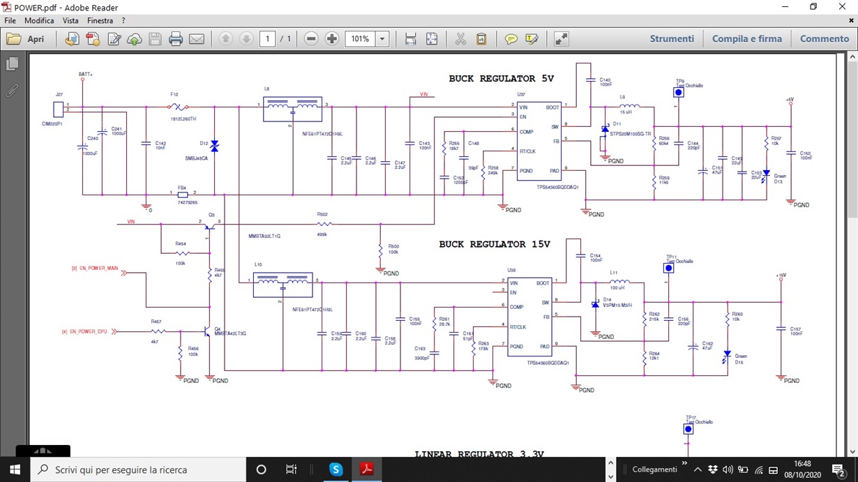

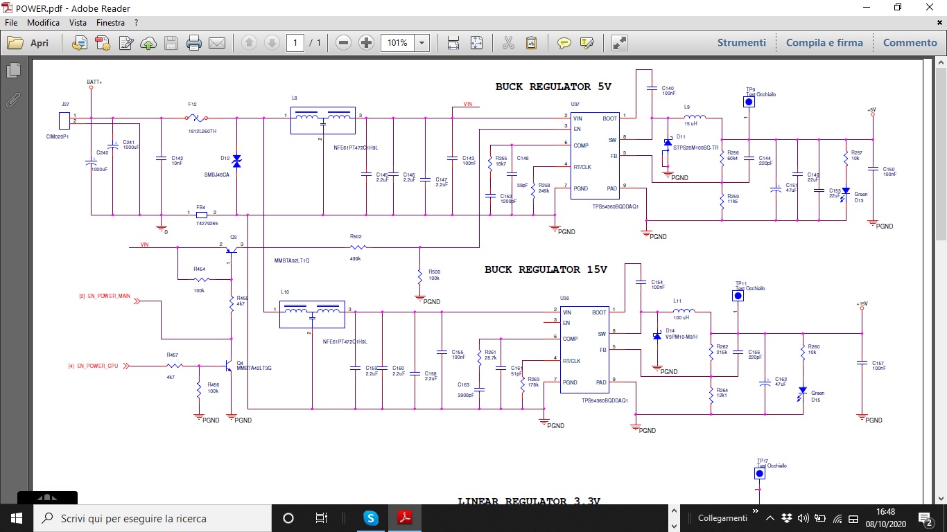

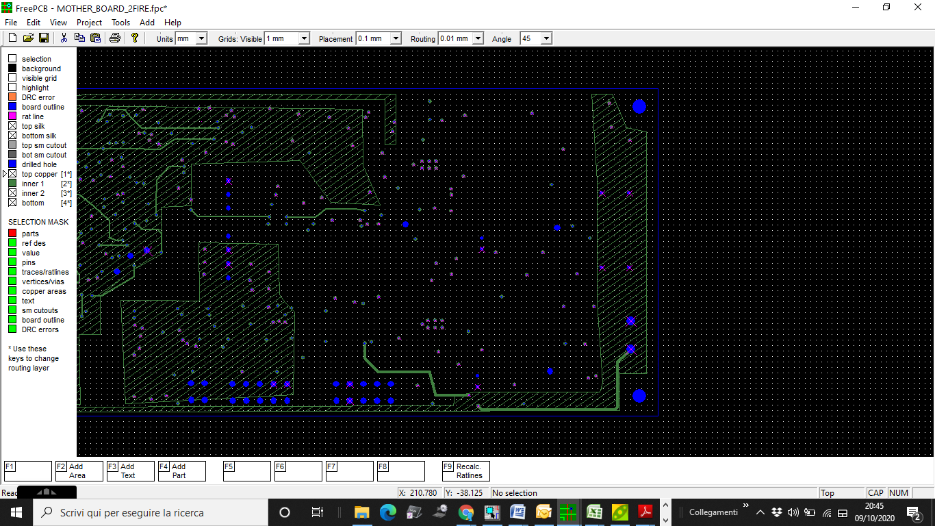

i have a power problem on a prototype board.
If the power supply reaches up to 30V input, both the 15V and the + 5v are regular.
If the power exceeds 40V up to 48V, I have two chip breaks.
I think it is the ENABLE, but in one case it is floating and in the other it is through two resistors. What is the problem? How to fix it?
The 15V are activated immediately, while the 5V is activated on command.
I attach the pdf of the diagram of the two power supplies
