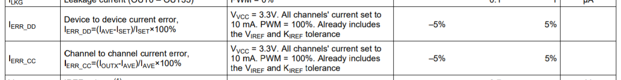

I'm looking at the following lines in the datasheet EC table:
Given two devices in a system, what is the maximum current error I could see between any two LEDs?    Is it possible for two channels on separate devices to have a compounding error (i.e. +/-10%)?
If we then assume that both devices are operating at the same junction temperature, does this error reduce?   If so, to what?

  • Hi Schelle,
    For Q1:
    Yes. the most worst situation is that the maximum current error between two device is up to +/-10%.
    For Q2:
    this error include the worst operation current error. it is affected by many factors. we can't guarantee that the error reduce in the same junction temperature.
