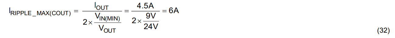

My customer is considering using LM5122 and calculating Cout.
Does IRIPPLE_MAX(COUT) mean the peak to peak current from COUT by charging and discharging?
If yes, why can it be calculated by equation(32)?

Hi Kuramochi,
It is supposed to. Maybe it uses some kind of simplification based on its inductor selection method.
But the inductor current ripple can be calculated as follows.
I_ripple = Vin*D/(L*fs)
Please let me know if you have any questions.
Yinsong
Yinsong-san,
Thank you for your support.
However, the shown equation seems to not matched with (32) as below.
Vin*D/(L*fs)=9V*(1-9/24)/(10uH*250kHz)=2.25A
Could you check again?

Hi Kuramochi,
Sorry I ignored the context. It calculates the output ripple instead of the inductor current ripple.
The output ripple is just the the inductor current divide by two.
The inductor current equals the input current so
I_output_ripple = Iin/2 = Vout*Iout/Vin/2

Yinsong-san,
Thank you for your reply.
>The output ripple is just the inductor current divide by two.
Is this because of VIN(NOM)=12V and VOUT=24V?
Kuramochi
Kuramochi-san,
Yes I think it is the simplification it makes here.
