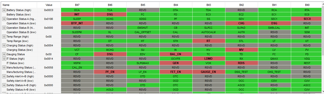

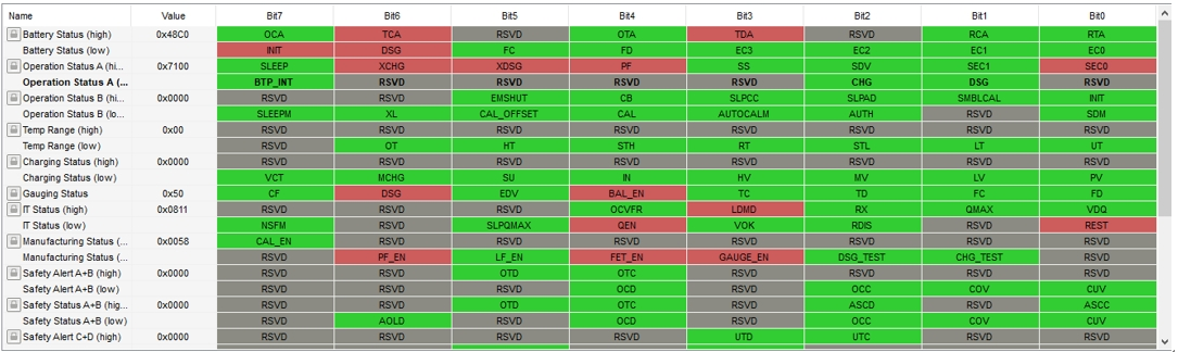

We have a case use the BQ28Z610. In our DVT sample. we found that some battery can not charge and discharge. Which means it can't be activated. We connect the batteries to Battery Management Studio, we found that some battery PF is set. After we clean the PF, the battery be normal.
Abnormal state
 After PF cleaning
