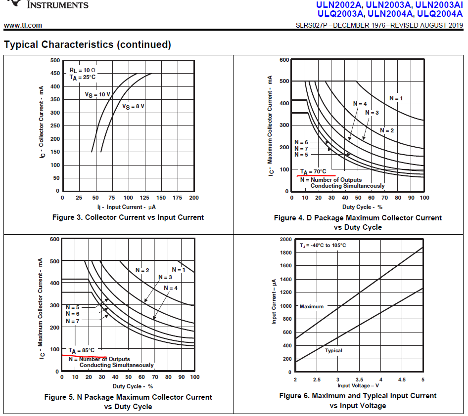

Our customer is requesting for ULN2003A D Package Maximum Collector Current vs Duty Cycle under TA=25C condition, but we are only having TA=70C data in datasheet, can you help to provide it? Thanks a lot!

Jacky,
Apologies but we don't have this characterization for 25C which we can provide, however, they should not very greatly from the 85/70C curves.
