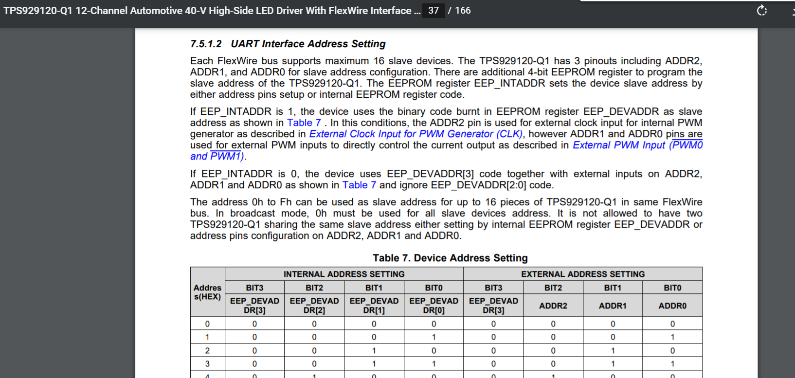

Dear Teams,
I have a customer who is asking whether they can use CAN transceiver and connect it to TPS929120-Q1, and the connection diagram showing in the following picture?
Also, at the other side of controller of CAN, it should connect to the UART or CAN's Tx/Rx?
Do you have typical CAN+TPS929120-Q1 connection example which can demonstrate to my customer?
Thanks!
