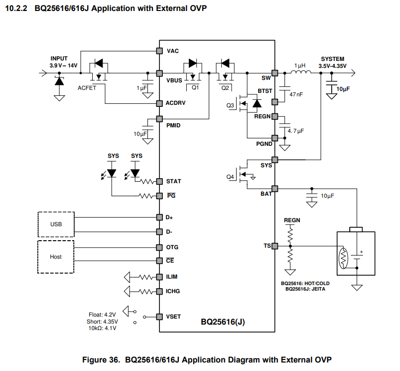

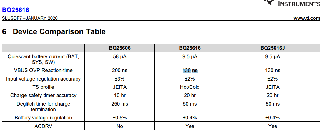

i have a question on BQ25616, from table below, 130ns reaction time only can be achieve by external N-FET or only for high voltage ACDC?
if ACDC is 5V output then no need?
