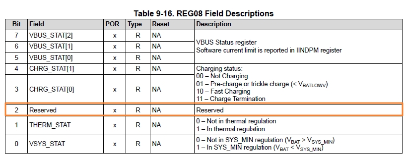

Hi TI team
Now we are using the BQ25601RTWR in the design and plan to update to BQ25611D,  we found some pin definition and register was changed on BQ25611D (PSEL, PG).
in the BQ25601 spec, there have two ways to let the sw to read the power good status (PG pin and register PG_STAT ), how to indicate this on BQ25611D now?
since PSEL pin was removed, How to detect a 12V input source and set the input current limit on BQ25611D?
