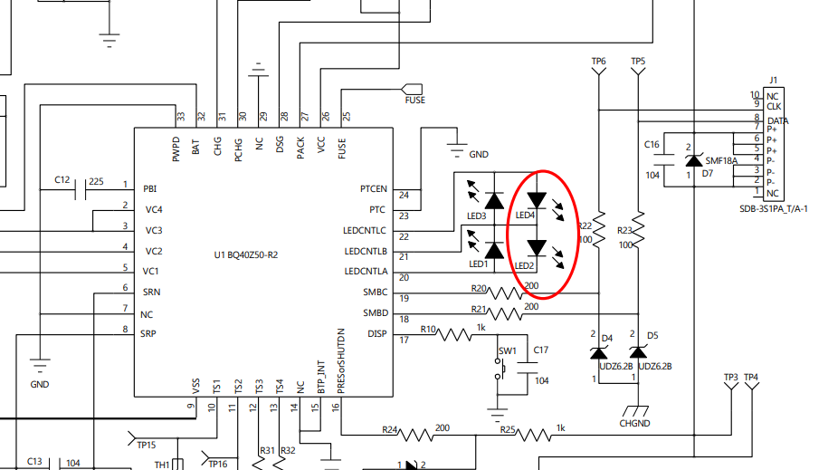

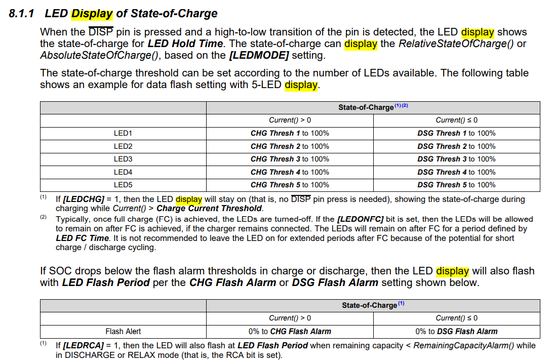

Dear Sir,
My customer is using configured 4 LEDs. and good working for Charging, discharging.
They have some problem as below table.
please refer to the attached GG file.SDB-3S1PA.gg.csv

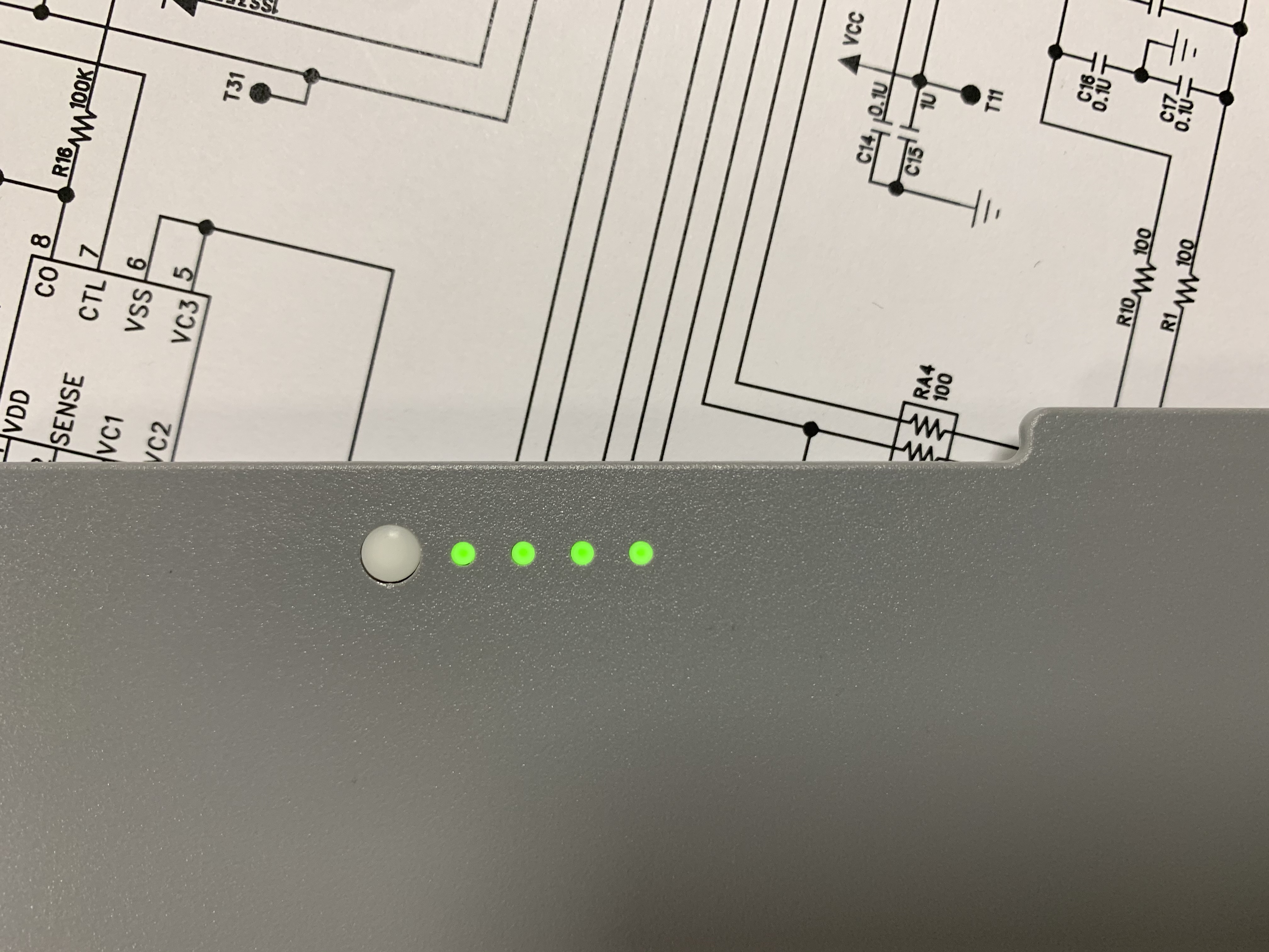

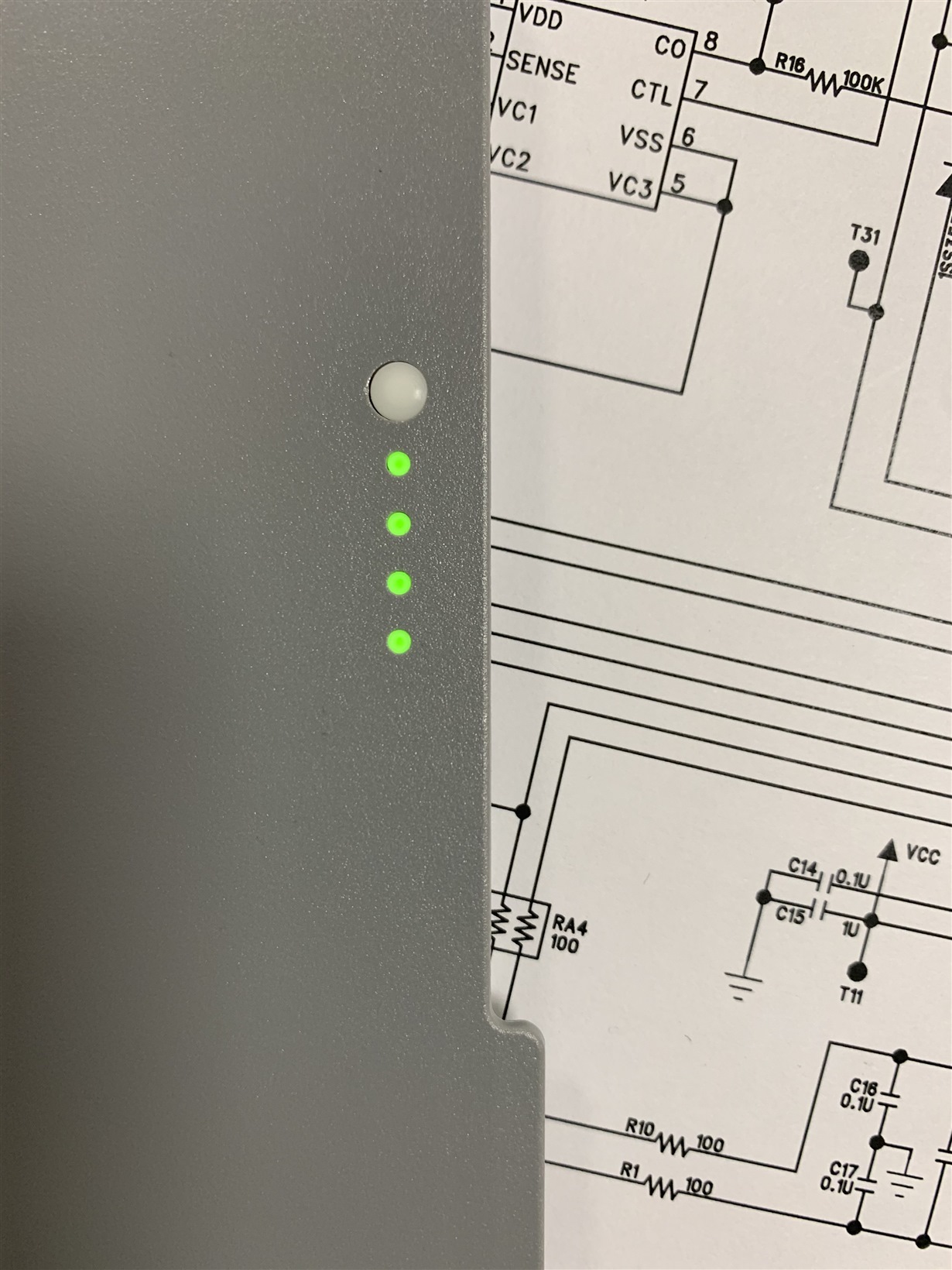

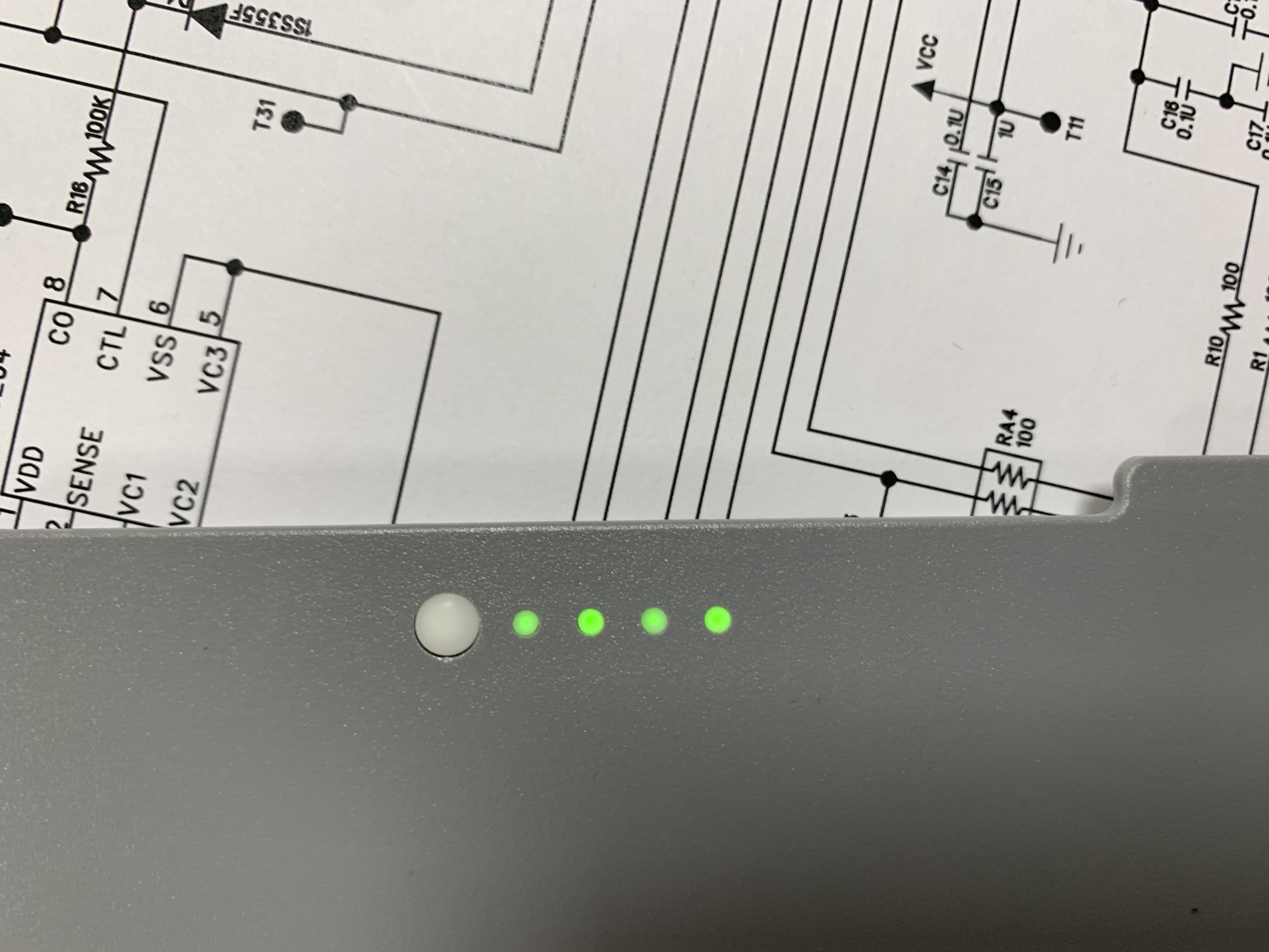

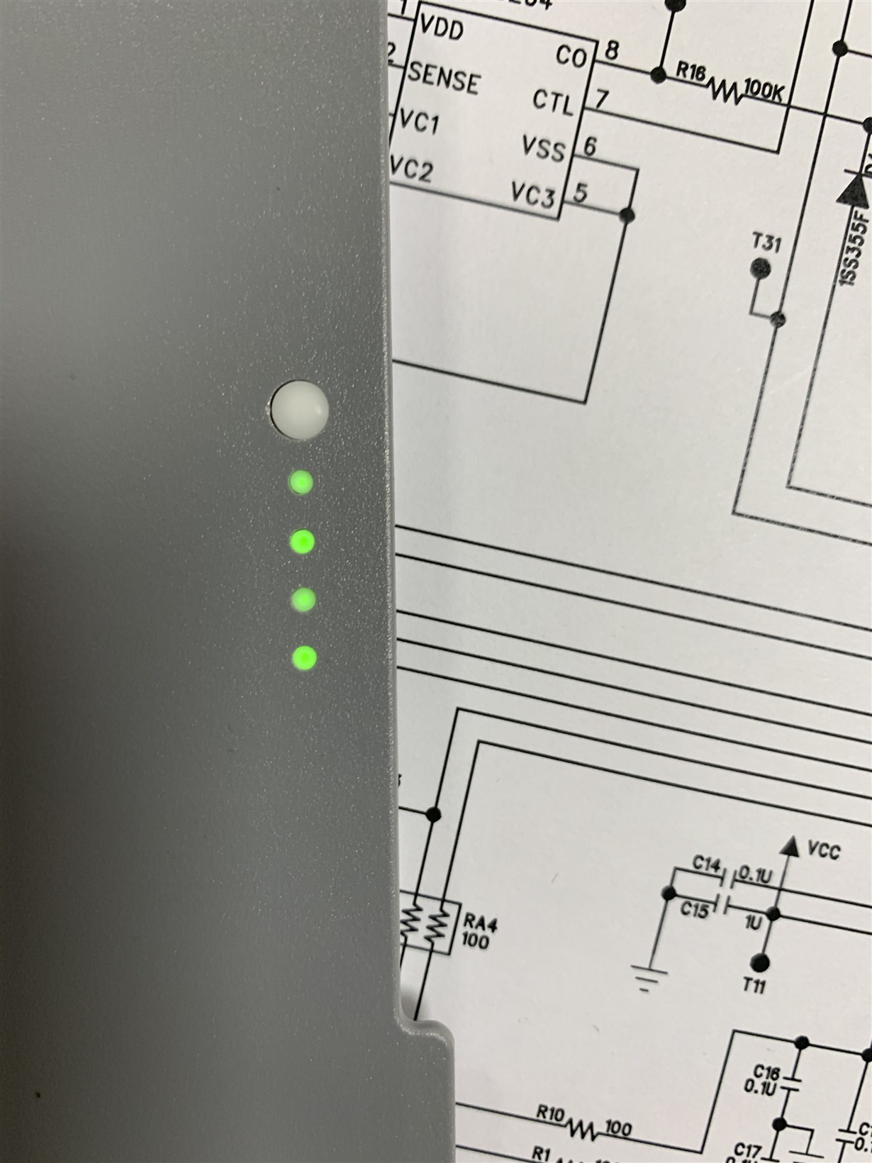

1. when charging done, 2 LEDs of 4 LEDs are blinking.
2. BATTERY gauge is jumped from 4% to 0% during discharging.
please let me know any advise about this issue.
