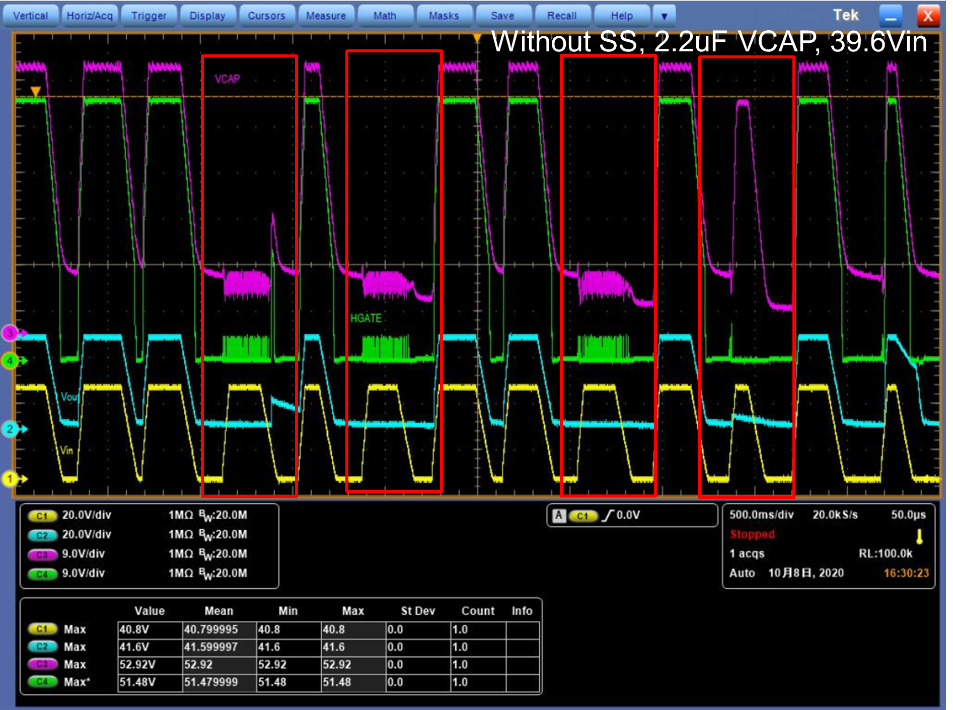

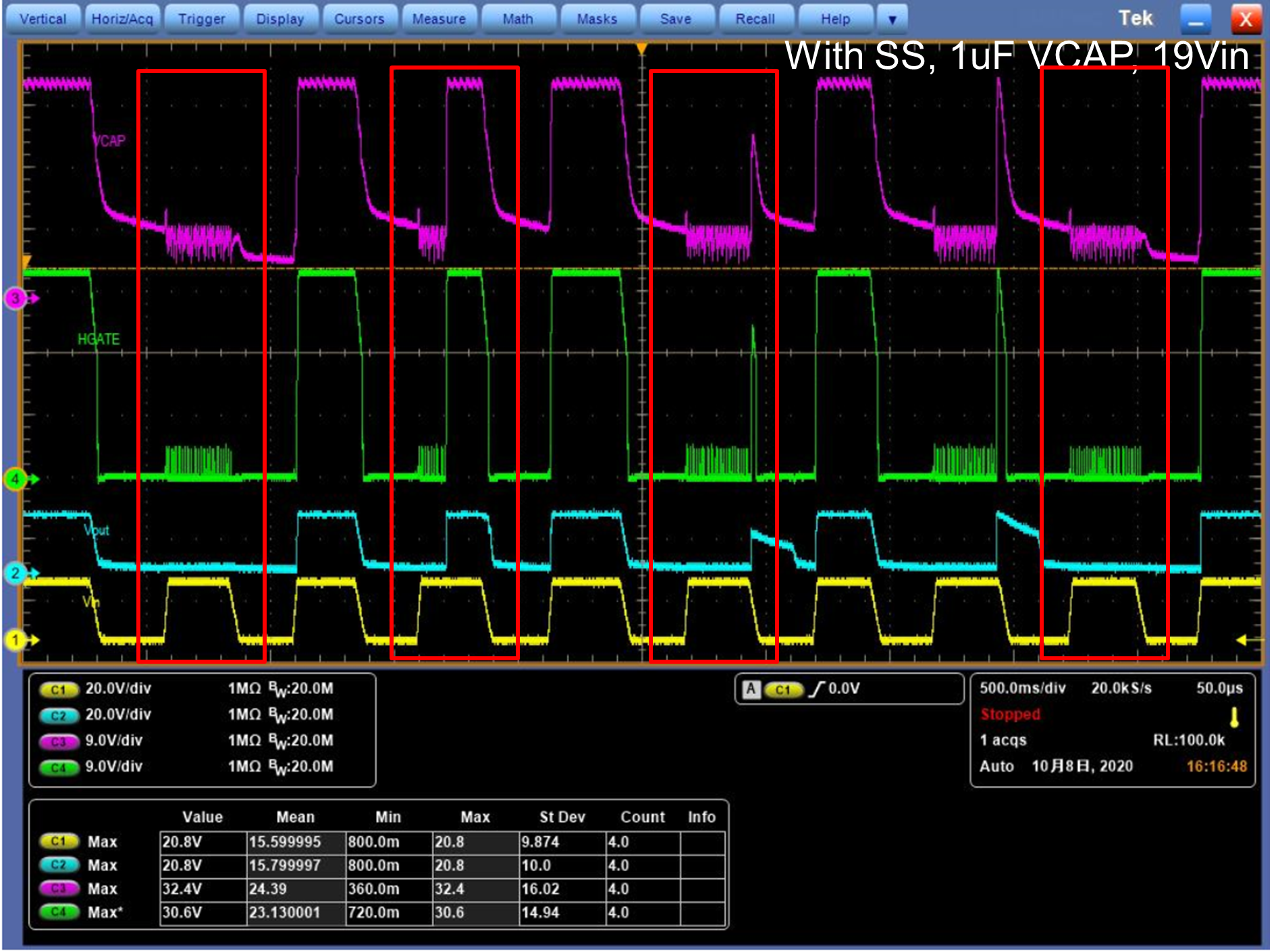

Customer has a issue on fast turn ON/OFF. There is a chance that system turn on fail. Please see below waveform for different conditions and I will send schematic with you via mail. May I know if LM74800 has turn on limitation that we need to meet? Turn on delay or other requirement.
Issue : Below is the original design from LM74800, there is a chance that turn on will fail.(in red rectangle). We thought it might related to driving power so we change VCAP and remove soft start.

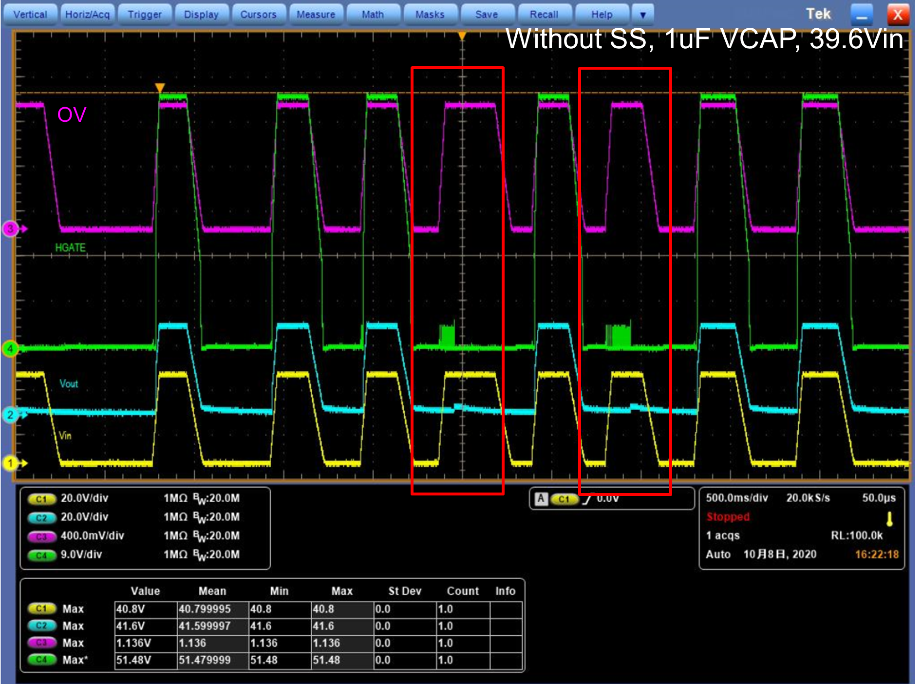

Step 1: remove soft start circuit and test. Result --> 19Vin would not see this turn on issue but there still chance to see this issue on 39.6V(higher Vin) condition.(we also make sure OV is not triggered)
Step 2:remove SS and change VCAP from 1uF to 2.2uF. Result --> issue is still there.
Step 3:remove SS and change VCAP from 2.2uF to 2.2uF*2.2uF. Result --> issue is still there.
