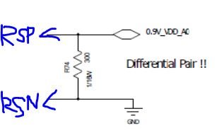

Hi team,
Customer is using TPS543C20 for 12Vin, 0.9Vout, Pout = 16W. For the remote sensing network, they directly sense the output voltage with the differential pair as below. One thing I want to ask is about the dummy resistor R74. I guess this resistor is not mandatory but used for keeping the level between RSP and RSN better. (Please correct me if any misunderstanding here.) Customer asked if it's okay with 150Ohm than 300Ohm. Could you see any difference on operation between 300Ohm and 150Ohm of dummy resistor here? Thank you for your kind explanation!

    There should be no need for this resistor between RSP and RSN if they are using 0.9V reference and sensing output directly.
    Is there a reference circuit where they saw 300ohm between RSP and RSN being used?
    Kris
  • Unfortunately, there's no reference circuit that I have. I was just requested to check if the dummy resistor 300Ohm can be replaced by 150Ohm on the customer's board. I understand that there is no need for this resistor. But do you see any potential issue if the customer uses this resistor?
  • I don't see a major issue with having the resistor there, but note that there will be 6mA of current flowing in the feedback path (0.9V / 150ohm). This will create a voltage drop based on the trace resistance in the remote sense lines and may reduce the output accuracy a little bit. For example, if the round trip trace resistance of the remote sense is 0.2ohm, then there will be an output error of 1.2mV (6mA * 0.2ohm).
