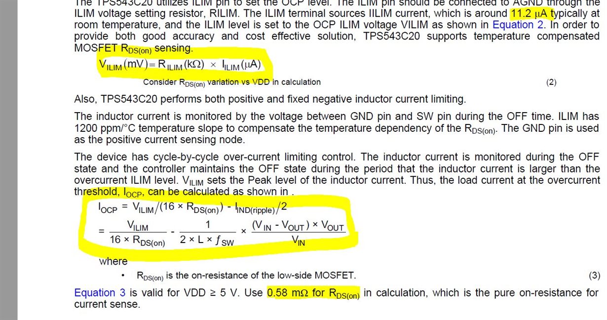

I have question regarding to OCP setting of TPS543C20.
The operating condition is 12Vin, 0.9Vout, 17.8Aout, 491kHz, Lout = 0.47uH. I follow through the DS with Rlim = 30.1kOhm.
Iocp = (30.1kOhm * 11.2uA) / (16 * 0.58mOhm) - ((12V-0.9V)*0.9V) / (2 * 0.47uH * 491kHz * 12V) = 34.5238A
However, when I checked the design in WEBENCH, it shows me OCP level of 21.631A with the same 30.1kOhm on ILIM pin. I ran the simulation with TPS543C20A, which is an enhancement version with HS FET having the same operation on OCP circuitry. I attached the WEBENCH report. Could you clarify the correct OCP level?
