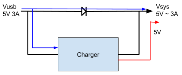

    Essentially a charger that accomplishes the very theoretical diagram below
    blue being external power (when Vsys is drawing ~3A charging would be disabled )
    red being discharge of the battery when no external power is connected.

  • Hi Jonas,
    The SYS output for all of TI's LiIon NVDC chargers cannot be set to a fixed output voltage.  It can be set to a minimum system voltage, to allow the system to power up with depleted battery, but will eventually follow the battery up as it charges to maximum (4.2V, 8.4V, 12,6V, etc.).  BQ25895 is the only charger currently available that was designed to have a  "system" load at PMID. So, you can place USB 5V at VIN and get 5V-IPMID*Rdson at PMID pin.  When VBUS goes away, there are 10's of ms delay before the charger can change over from charge to OTG mode and regulate PMID to 5V.
    I will follow up with our development team and get back to you if there is a product coming soon that can do this.  But, most likely, there will be a delay before the converter can switch from forward (charge) mode to reverse (OTG) mode which will cause a dip in the 5V rail.
    Jeff

    So does that mean PMID will follow Vin when external power is applied? If so, what is the current limit of PMID, still 3.1A?
    Ex. If 12V is applied at Vin, would Vpmid = Vin - Ipmid**Rdson, if so, could PMID supply ~12V at ~2A (only during external power)
    "slow" switchover is okay for our application, each external device has a battery of some sort
    I am interested to hear if any new ic is in the works.
  • Hi Jonas,
    The FET between PMID and VBUS is used for current sensing and reverse blocking only so PMID follows VBUS.  There is no current limiting from VBUS to PMID, as current limit in either forward (charge) or reverse (OTG) mode is performed by limiting the converter duty cycle.  If a load pulls current from PMID in forward (charge), the charger's converter is "starved" and may have to rely on the battery to supplement the SYS load.
    Jeff
