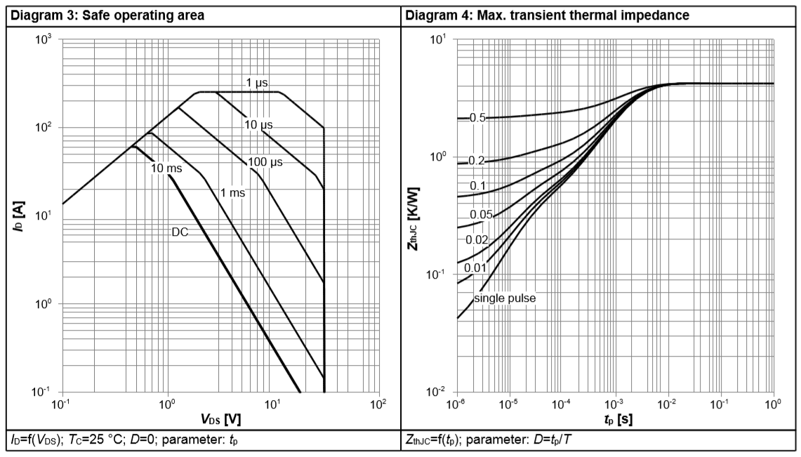

I would like to ask why '77915 SCD so long (1msec)? My MOSFETs burned out:( (I did not checked the safe operating area only the peak pulse current).
My experience, using PowerSO-8 (TDSON-8) MOSFETs and 5 cell design, one series FET switch circuit not enough due to long reaction time (overdisspation).
In other words, if SCD were shorter single (or smaller) FETs could be used.
In case of stacked application (higher voltage->larger short current) using parallel FETs is mandatory, however application note does not mention it.
The voltage on the FET ca 2V (voltage divider action between Rdson and pack + short resistance). I think 50..100us SCD would be accepted.
Can I reduce SCD reaction time allowing to use singel FETs because my board space very limited (no place for parallel FETs..)

    The SCD can be either 0.96 or 0.4 ms, depending on what version of the device you are using. This is fixed in the programming and cannot be changed by the user.
    The only thing you could change is the CHG and DSG FET rise and fall times, this is outlined in section 10.1.1.1 of the datasheet. However, it will probably not be able to get down to 50 or 100us.
