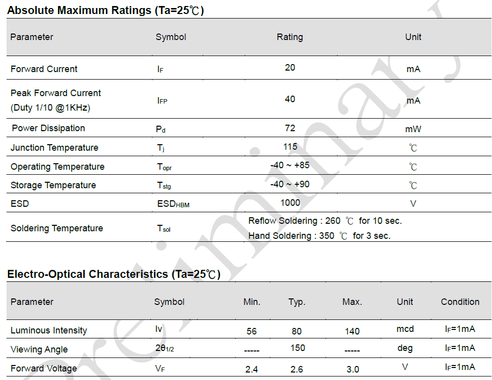

We are looking for the LED solution for mini LED TV. Some of requirements and LED spec are shown in below.
Application: mini LED TV
Mini-LED quantity: 15360PCS
Partition: 960 area matrix
One Driver IC controls 16 LEDs
Controller IC single control 16 Driver IC
Input voltage: 5V
