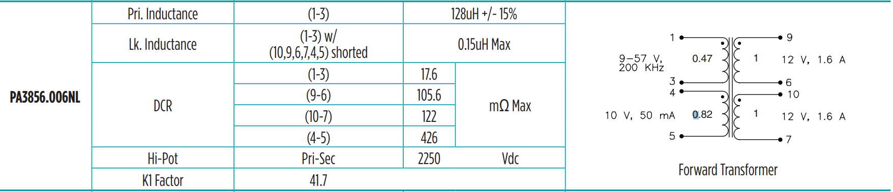

I would like of to know if it is possible to use the PA3856.006NL (PULSE) to make a power supply with 18 - 36Vdc input and 12V@2A output?
But to power the UCC2897A, i will not use auxiliary transformer of PA3856.006NL.

Hi Jose!
Thank you for getting in touch and for your interest in the UCC2897A! At a short glance it seems like the transformer inductance is a bit low for those specs, but I think I might be missing some information. Your image is not visible, can you reupload using the "Insert/Edit Media" button in the posting toolbar?

Hi Jose!
The transformer inductance seems a bit low for your given specifications but I don't think using the PA3856.006NL for a design would be impossible. Do you have a schematic I could look over?
