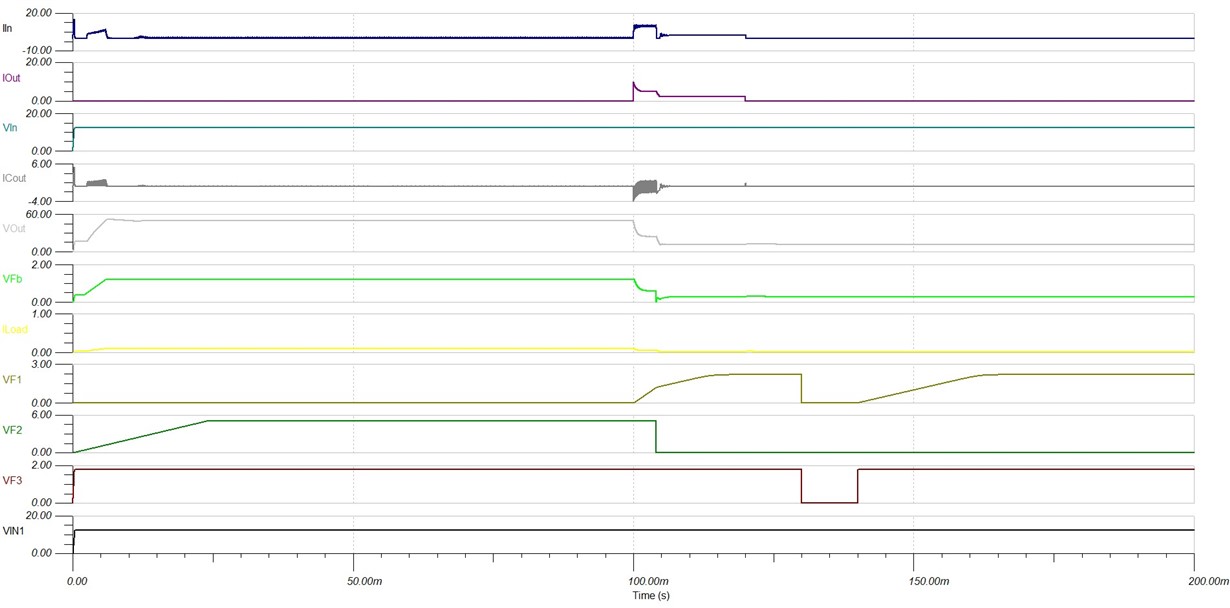

    Will shut down cycle on UVLO restart the operation?
    I do the simulation with shutdown cycle on UVLO but LM5122 does not restart.

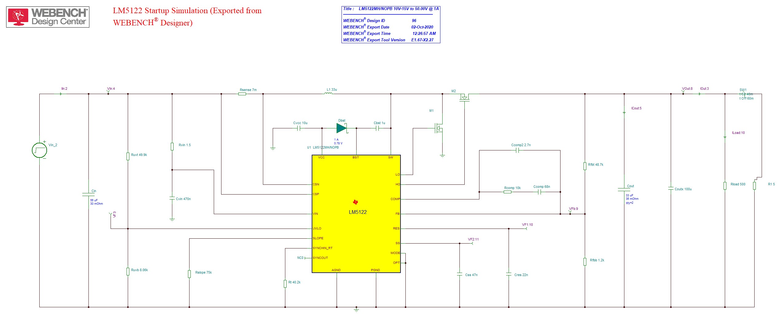

    The simulation circuit is shown in the following picture.
    The siwtch SW1 will close at 100 ms and open at 120 ms.
    The switch SW2 will open at 130 ms and close at 140 ms.
    But the output voltage does not recover and voltage on SS pin is still low.
    Bowebench_design_4621751_96.TSC

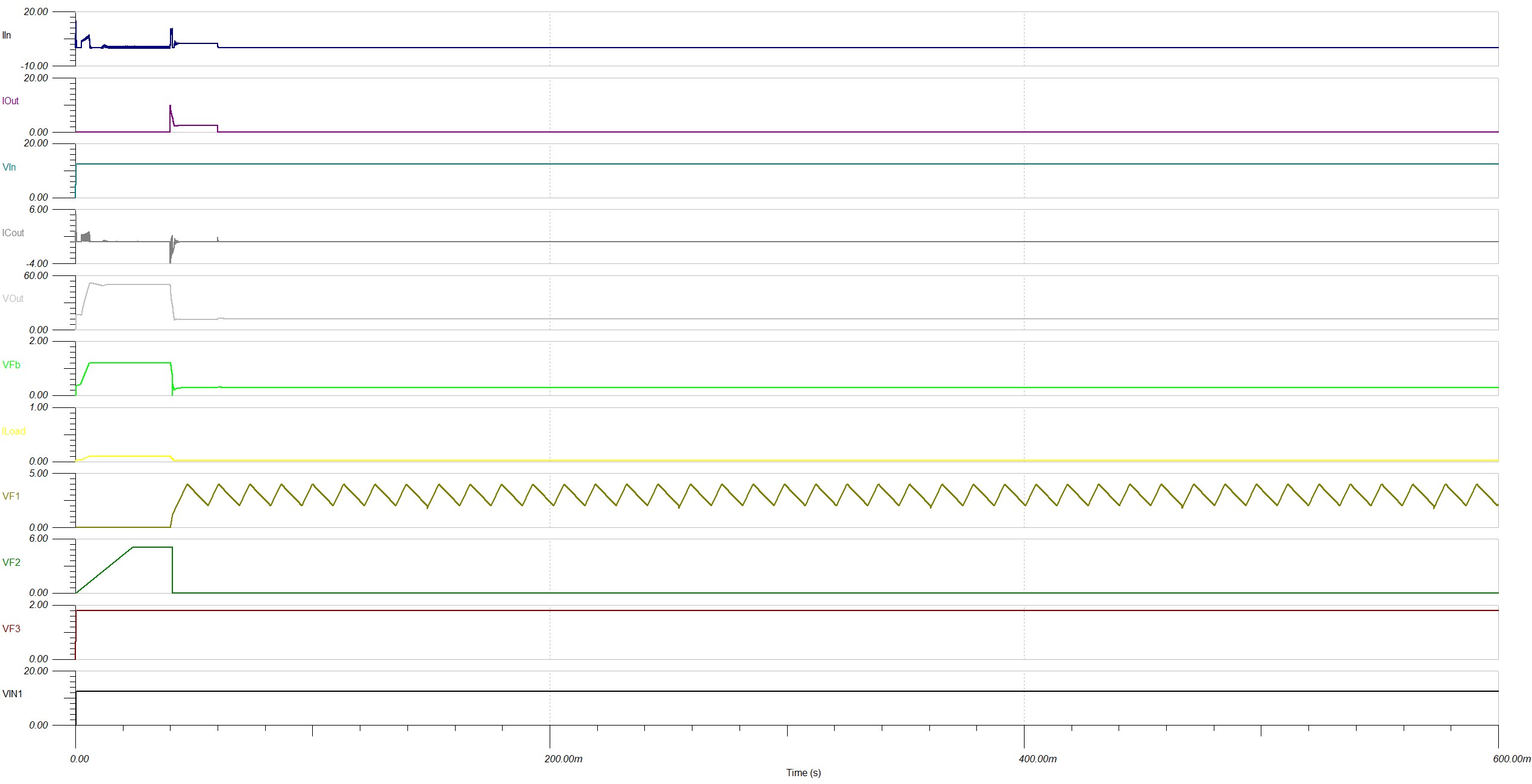

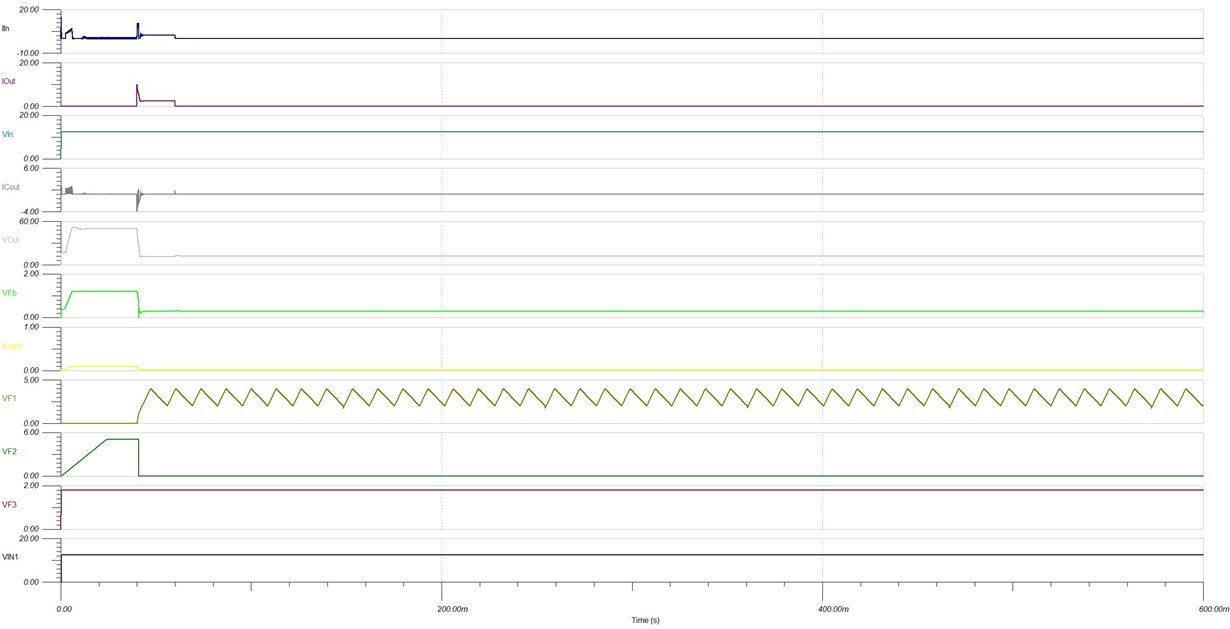

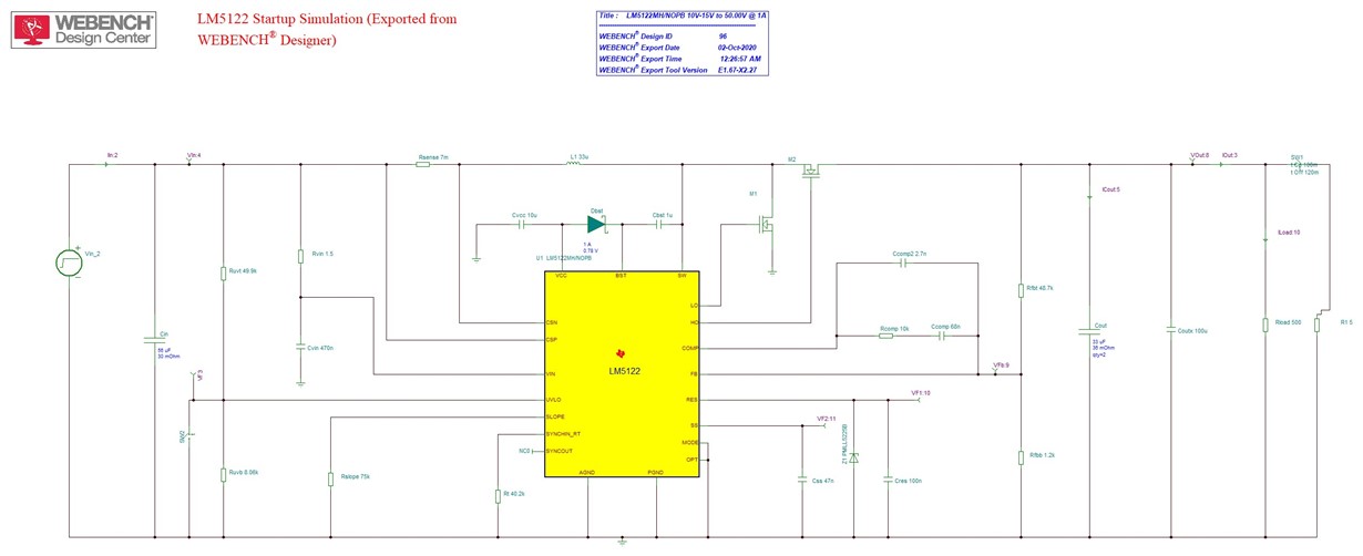

    I did another simulation. I can see the charge and discharge circle on RES pin. But after 8 cycle, I do not see the recovery voltage on output and SS pin keeps low voltage.
    Does the spice model include the recovery from HICCUP mode?
    During simulation, SW1 will close at 40 ms and open at 60 ms.
    The simulation circuit is following.
    Bo
    2845.webench_design_4621751_96.TSC
  • Hi Bo,
    I am looking into the model and will get back to you in a few days.
    Please be aware that the silicon will operate as described by the datasheet.
    I saw your other post and I don't think for the application that hiccup mode is going to be needed. The RES pin can be tied to ground to disable hiccup mode. This way the large output capacitor can always be charged with out the LM512 entering hiccup mode.
    Please let me know if you have any questions.
    Garrett
