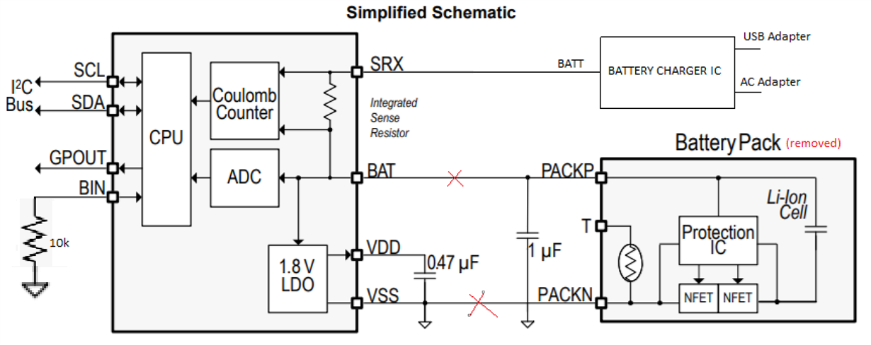

In BQ27421YZFR-G1A when SRX pin is connected to battery charger IC and the Battery is removed from fuel gauge BAT Pin and there is an input of USB charger current from battery Charger IC to fuel gauge through SRX pin.
  1. If battery is disconnected, would the charger supply voltage drive BQ27421 LDO?
  2. What would be the SoC reported from BQ27421, in this case? Note: battery is disconnected
