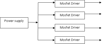

32 Mosfet drivers have been used as 32 liner drivers, the frequency of line driving is 2MHZ, the capacitance of each load is 200pf and the power supply is 15V.
Based on those data, the min power needed is P = 32 x f x C x V x V = 56watt and the current supply is 3.75A.
Since each Mosfet driver can sink 117mA current, the rising time of output wave would be trise = (C x V) /I = 897ns.
My question is all those 32 Mosfet drivers share the same power supply, how I can make sure each Mosfet driver can sink the same current?
Can I use current limiting circuit or use any commercial chips from TI?
  • Any suggestions?
    Thanks.
  • David,
    The power you calculate is the average power which you use to rightly specify your required power supply for your circuit. However the sourcing and sinking of the drivers is a lot greater than 117mA. In fact the UCC27322 can source up to 9A for short periods of time. this instantaneous current would be sourced from the local capacitor on VDD of the driver. The capacitor value would be based on the gate input capacitance, driver source current and acceptable voltage dip on VDD (maybe 0.5V to 1V).To reduce this current level you could add gate resistors to each MOSFET, but this will slow down the turn on and turn off of the MOSFETs, which will cause significant losses since you switch at 2MHz.

  • David,
    I don't have a reference design but the process would be:
    1. estimate the rise time of the MOSFET, tr = Ci x Vg / i_drv = 200pF x 15v / 4.5A (9A for a short period) tr = 667ps
    2. Calculate minimum VDD capacitor, C_VDD > tr x i_drive / dV, (dV allowable ripple on VDD) C_VDD > 667ps x 4.5A / 0.5V = 6nF, use 10nF per driver. In fact the driver data sheet recommends 1uF at VDD (pin 8) and PGND.. and a 0.1uF capacitor from VDD (pin 1) to AGND. these far exceed the calculated minimum and should be the values used.
    3. Ensure C_VDD is placed right at the VDD and PGND pins of each driver.

  • Since the continuous current from power supply is 118mA, I can use dt = C times dv/I to calculate the charging time for that local capacitor. C= 1uF, dv=15V,  I =118mA.
    dt = (1uF x 15V) /118mA = 127uS.
    The means that local capacitor can’t be charged in 250nS to meet 2MHZ driving frequency.
    I have to increases continuous current to reduce the charge time or use a lower value local capacitor such as 10nF.
    How do you think?
  • You only need to charge the 1uF capacitor from 0 to 15V one time, i.e. at initial start up. When switching, these capacitors only discharge a couple of mVs. The 15 term in your equation above becomes mV's.
    Also I reviewed your math and I am not sure that you have your initial calculation correct.
    P = 32 x f x C x V x V = 32 x 2MHz x 200pF x 15 x 15 = 2.88W (not 56W????)
    looking at the driver capacitance, driver current and  gate voltage ripple we find the following.
    C_VDD = 1uF, I_drv = 4.5A
    tr = C_VDD x Vg / I_drv = 200pF x 15V / 4.5A = 0.667ns
    during tr VDD discharges by dV = I_drv x tr / C_VDD = 4.5A x 0.667ns / 1uF = 3mV
    VDD capacitor charges during the remaining period of the switching cycle, 1/f - tr.
    Current to charge the VDD cap 3mV during this time is
    I = C_VDD x dV / (1/f - tr) = 1uF x 3mV / (1/2MHz - 0.667ns) = 6.01mA
    so for 32 drivers it is 192.3mA or 2.88W at 15V.
