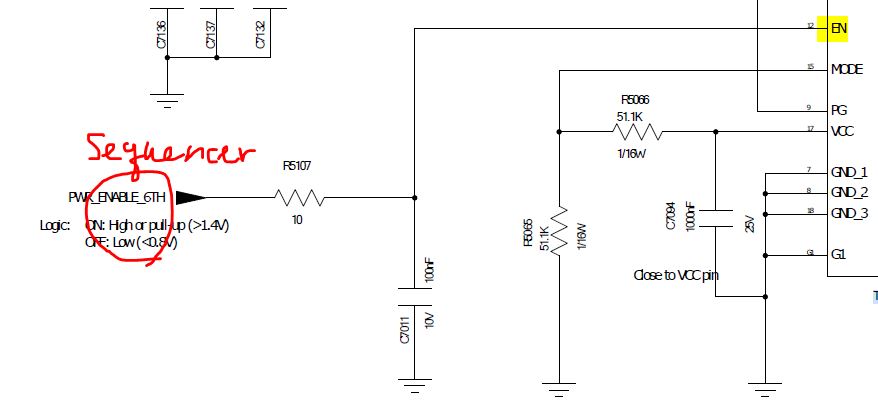

Customer needs a current spec required for EN pin to check if the current consumption by EN pin is met the sourcing current spec of the sequencer.
As per the DS, TPS568230 has an internally pull-down current source of 2uA when VEN = 0.8V. Does this mean that the sequencer should source typically 2uA when the pin pulling below 0.8V, while the device consumes 2uA? And how much of current would be consumed when the device ON (the EN pin pulling above 1.4V)?
