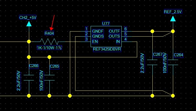

REF3425: Does EN pin need series current limiting resistor?
