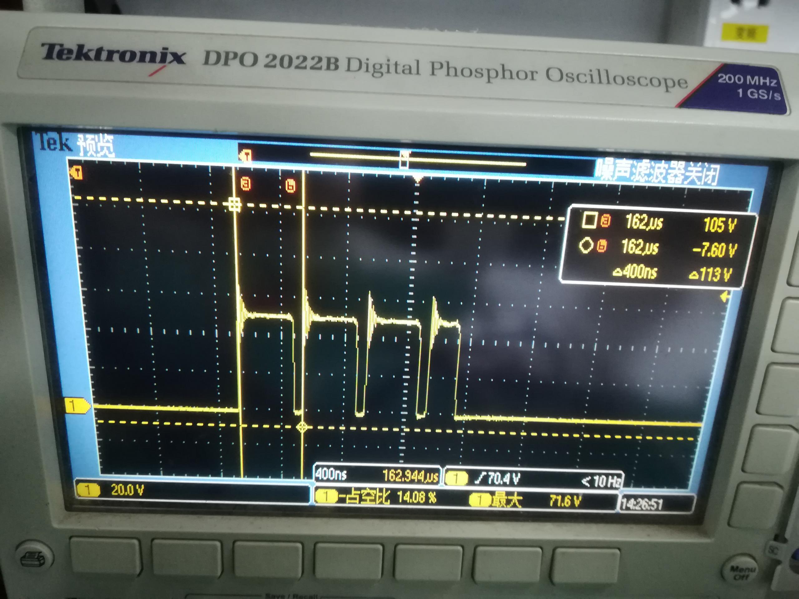

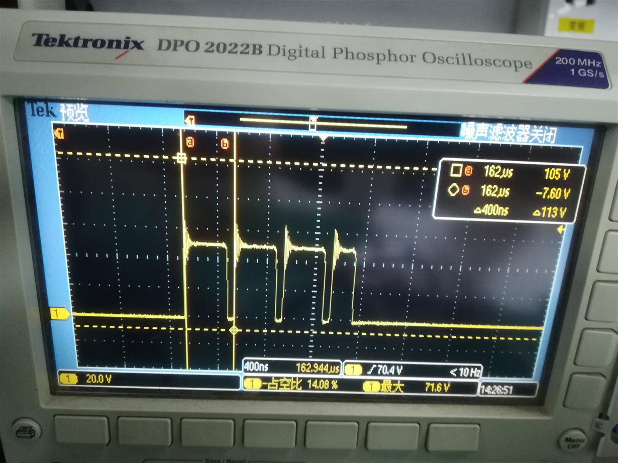

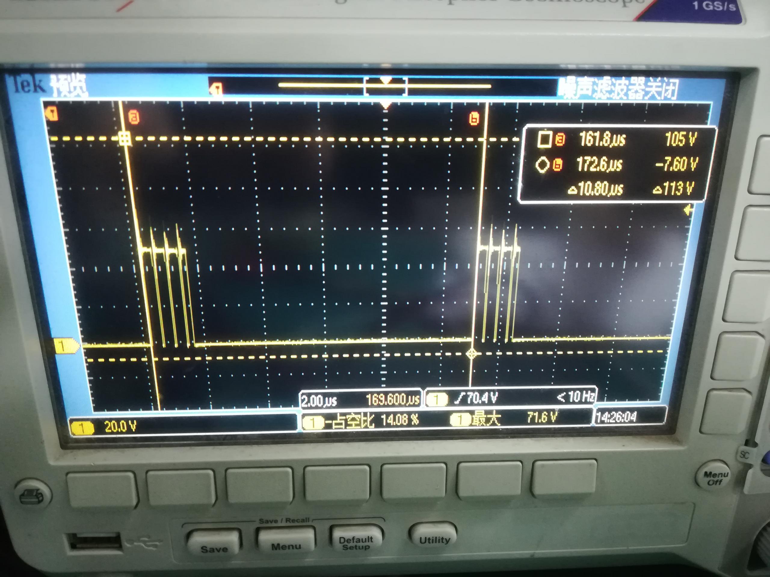

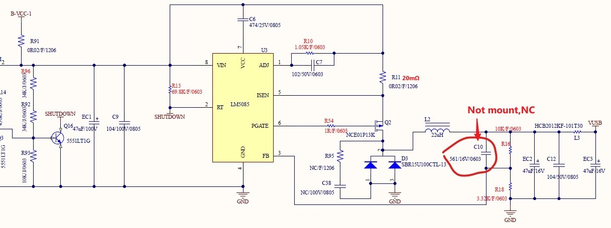

my csutomer's schematic is as below [39-58.1V input, 5V/2A output]. , they used the lowest cost configuration according to LM5085EVM user guide. but they found the waveform of SW node is not normal,  seems to be two waveforms of different frequencies mixed together.  please help to suggest  how to further analyze this problem? thanks.
SW node waveform:
zoom in
