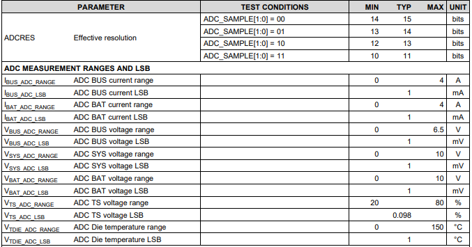

    We measured it using EVM and bqstudio.
    To get an overview of ADC accuracy with EVM,
    we tested it with a charging voltage of 8.4V and a charging current of 100mA.
    ・Multimeter result is 99mA
    ・ADC sensing result is 75mA (bqstudio)
    From the above results, it was found that ADC sensing has rough accuracy.

    I am observing similar behavior on my side as well. Unfortunately we do not offer any performance warranty on the ADC accuracy. Additionally at such low currents the signal going into the current sense amplifier is pretty small. This makes the resulting ADC read out subject to inaccuracy.
    If sensing currents this small is a customer requirement, then an external current sensing solution should be applied.
