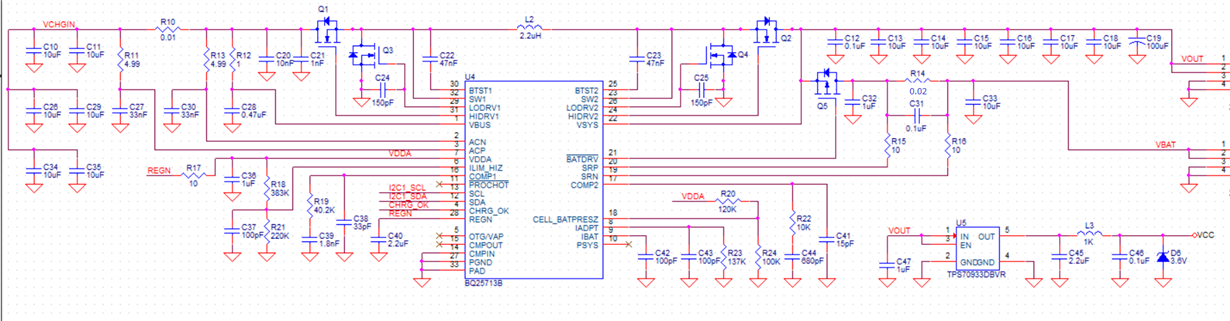

I'm working on MPPT project with 2S2P Li-Ion battery pack.

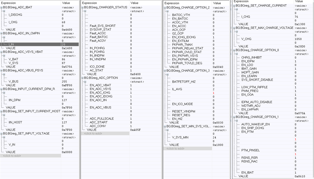

I'm facing a problem while reading the input current from 0x2A register.
Below you can find my schematics:

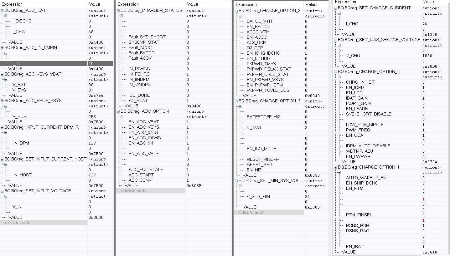

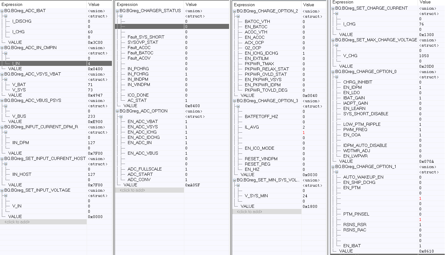

Below you can find all registers readings:

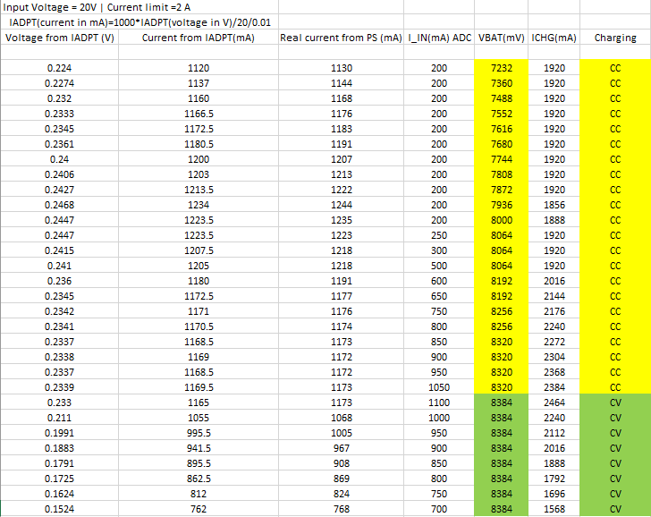

I have also made a table with both CC and CV charging:
As you can see from the table, once the charger passes to CV phase of charging (battery voltage = 8384) I start reading the actual input current, until that point I mostly read 200 mA and then the reading starts increasing till the right value.
