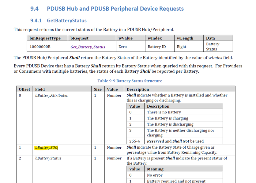

I have question about USB PD battery status message.
In USB PD specification section9, there is command "eBatterySOC".
By utilizing "eBatterySOC", I want to check battery status via CC communication.
 e.g. check mobile battery(source) status from sink equipment via CC communication.
Does TI have USB PD solution which utilize "eBatterySOC"?
Also, if we want to know the battery status, using battery fuel gauge is only way?

    TI has all of the pieces needed to meet your "eBattery SOC" requirement.  The TPS65987/8 USB PD controller can send and receive Battery Status messages, but an external uC needs to fill in the battery information.  Many of our chargers are able to provide status info via I2C such as to whether the battery is charging or discharging, but for specific details we would need to know the specific part number you would like to use.  As you said, a fuel gauge IC is the best way to get the state of charge information.
    To summarize, a uC reads the information needed to fill in the Battery Status Structure from a combination of charger and fuel gauge registers and then sends the BatteryStatus message using the TPS65987/8 USB PD controller.  For more information on the USB PD messaging, you may want to post a message to the USB PD power forum under the TPS65987 part number.

    1.
    Is the command "Get_Battery_Status" used on USB data line(D+/D-)?
    Is it possible to send/receive "Get_Battery_Status" on CC line?
    2.
    In USB specification, the command related with Battery status is described as "Shall".
    In generally, all battery which support Power Delivery support such command?
    If you know, I would appreciate if you would tell me.

    1.  The "Get_Battery_Status" USB PD message is only sent over the CC line.  I am not aware of any standard that supports sending this message over D+/D-.
    2.  I am afraid that I don't know the answer to this question.  I have worked with other customers who have implemented this support, so I know that at least some battery-powered PD systems do support this command, but I don't know what percentage of all the products in the market have implemented this.
