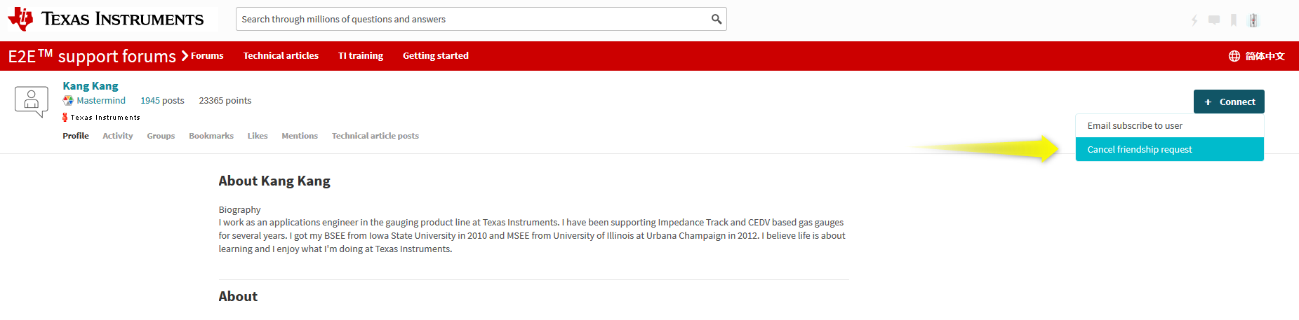

Hallo Kang,
thanks for your answer.
As you can see in the following picture I can only cancel the friendship request.
So If I undeserstand this system right, you have to accept my friednship request.
Also I think you as Ti employee can send me a private message without being a friend.
For Example Matt Sunna, Shirish and David Hien did that in the past.
Or should I do something else?
Thanks for helping us.
