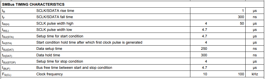

We are using BQ24780S charger IC in our design.
In this we have used 10Kohm pull-up resistor and 42ohm series resistor in our SCLK and SDA lines. Also, we have calculated the total capacitance in SMBUS lines approximately 100pF, includes trace, cable, protection diode capacitance, board and charger IC pin capacitance.

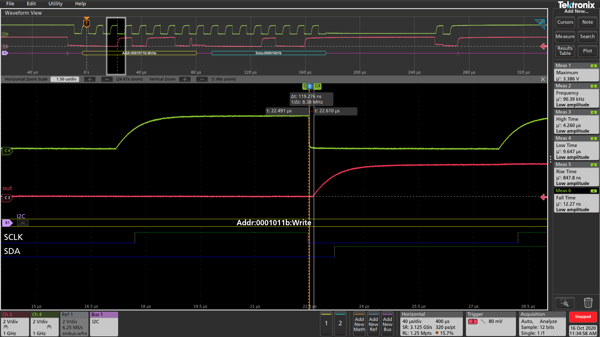

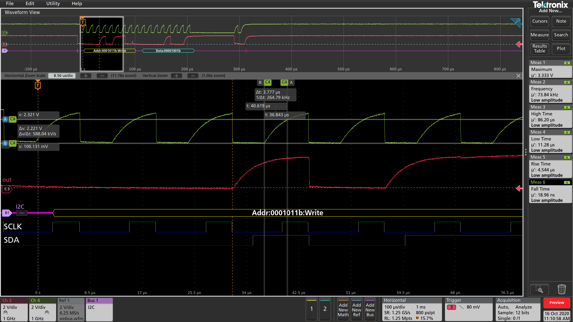

We have done AC analysis for the SCLK and SDA lines and waveform is shown below
The rise time is 4.54us which does not meet the SMBUS timing limit that is greater than 1us (as per datasheet)
The Fall time is 18.96 ns.
The setup time and hold time values of the SCLK and SDA is meeting as per requirements.
Whether the above rise time value is acceptable.
