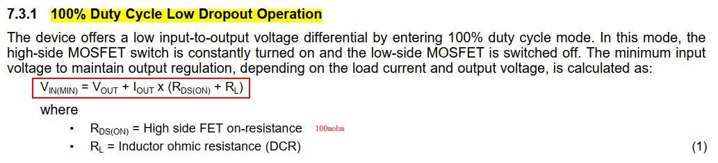

Here my customer wants to evaluate TLV62569A in their case, the VIN range is from 3.4V`4.2V, the Vout is fixed 3.3V. They want to confirm if there is a concern when working under VIN_min=3.4V, Vout=3.3V, Iout=800mA?
I found below in datasheet, it seems that TLV61569A can achieve 100% duty.

    What is the DCR of the inductor used? Please look for this parameter and calculate using the above equation. If it satisfies the condition, then the output will be regulated properly. (Typically, inductor should be chosen as per the d/s specifications)
    Febin
  • Hi Febin,
    The DCR of inductor can be chosen as low as 100mohm reported by customer. And update customer's requirements here:
    Vin= 3.45~4.2V(1-cell battery), Vout= 3.3V, Iout= 1.0A continuous.
    So it seems Vinmin= 3.3+1*(100m+100m)=3.5(V). It's not okay, right? Need your comments and judgements.

    You might have already noticed that, the DCR of the inductor used in the typical application examples in the d/s, is much lower.
    Also, with the above mentioned conditions you will not be able to satisfy the min Vin condition.
    1) For 100% duty cycle operation and with the listed conditions, TLV62569A would be challenging.
    2) Will you be able to share some more details on customer, time line, etc.
    We have a new device lined up for APL next week and it would be a good choice for this Application. TPS62826A, 2A forced PWM version of TPS6282x family.

    Thanks a lot for help,TLV62569A  seems not match customer's requirements, I will follow up and let you now if any update.
