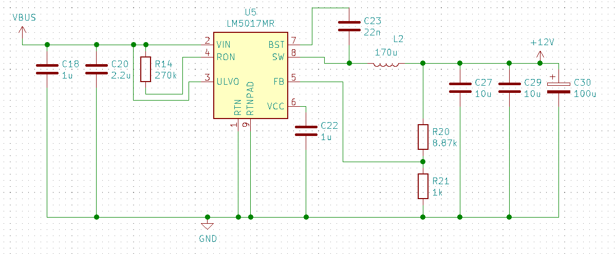

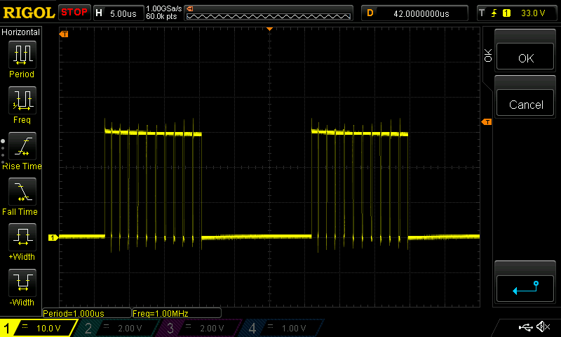

Hello, I am observing the following waveforms at the switch-node of my LM5017 buck converter design.
The converter is driving a ~25mA load at 12V, with an input of 30V. The schematic is included below.
The Toff is too large to be caused by exceeding the peak current limit, which should be less than 2uS under these operating conditions. What else could be causing this behavior?
