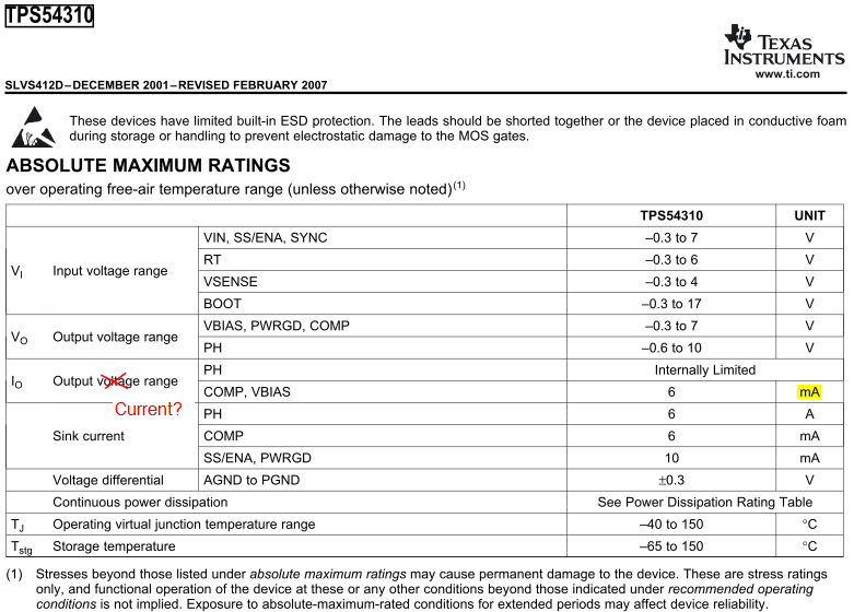

I would like to ask one question about TPS54310 used on EVM6437.
It seems that IO should be “output current range” rather than “output voltage range”? Is it a typo in SLVS412d?
