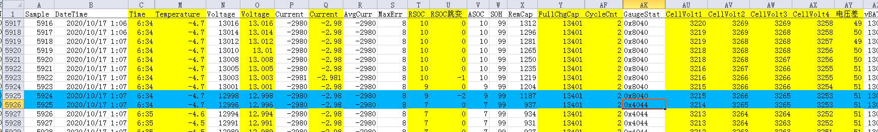

BQ4050: The 4S6P battery pack uses the BQ4050 fuel gauge IC, and discharges at a low temperature of -10°C. The 0.2C discharge SOC is from 100 to 0%. The FCC has not been updated. Please help to see what is causing it? The attachment is the GG file, the log
    Check section 6.3 Capacity Learning (FCC Update) and Qualified Discharge in the TRM, if the temperature drops below the learning low temp threshold the gauge will not update the FCC (disqualified discharge).
