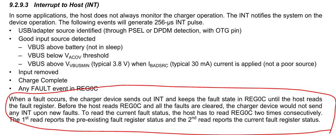

Hi TI team,
Based on the description of INT in BQ25898 datasheet, when an INT was sent out, 1.Before host read it, the Fault state will maintain even if the fault disappear. 2.There will no other INT pulse sent out even if a new fault accured.
It seems there will be a conflict in this case: After a fault is sent out, and the host miss to identify the INT pulse, so the host will not read BQ25898. Afterwards, there is a new fault accured, there will be no INT pulse sent based on the INT principle in BQ25898 datasheet. So the host can't read BQ25898 again.
Please confirm how to handle this case.
