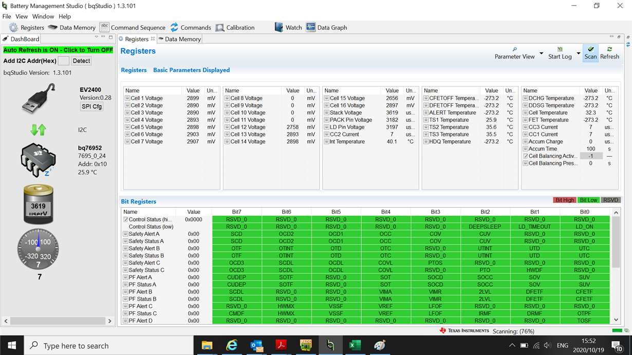

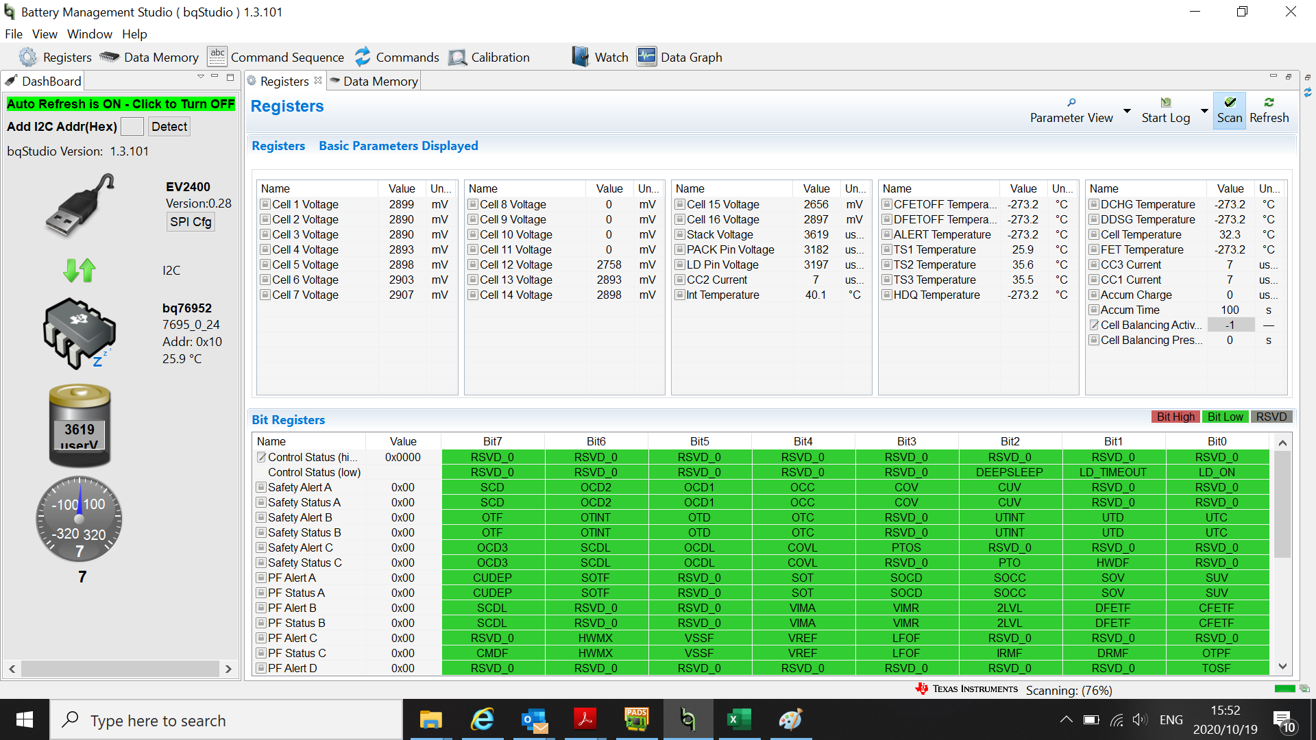

Could you pls advise how to active special Cell balancing? and how to check special cell balancing status?
I am using BatteryManagementStudio-1.3.101_Build1.

It looks like you are using the pre-production version of the device which does not have the cell balancing feature enabled. The final version of the device is now available for order. You will either need to replace the IC on your EVM with the final version or you can order a new EVM (final version is now released).
When you get the final version of the device, you will need to update BQStudio to version 1.3.102 which is now released.

thanks for support, after replace IC and update BQStudio balancing works now.
