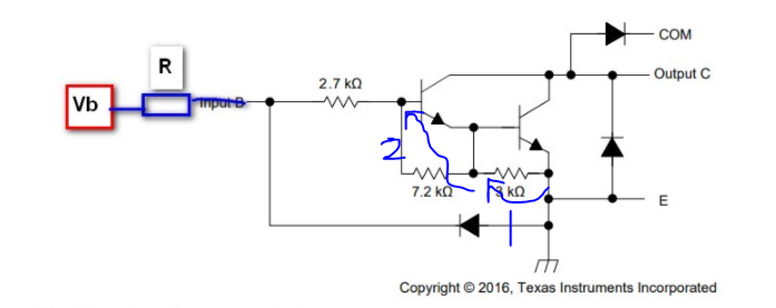

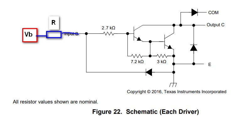

  • Could you please give an example how to select the series resistor and Vb?
    For example, Iout=100mA @25Celcious is needed.

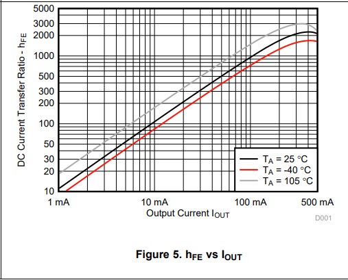

    How to understand Figure 5. hFE vs IOUT? Iout =hFE*Ib, according to Figure 5, Iout is Monotone increasing with hFE.
    IF Iou=100mA, hFE=1000, so the Ib=100uA, right?
    then how to apply Vb and the external series resistor R to realize this.
    You are correct, and it is measured at input pin to output pin. and is the LARGE signal current gain. For darlington pairs, you consider the hFE1*hFE2=hFE of the darlington pair.
    Right.

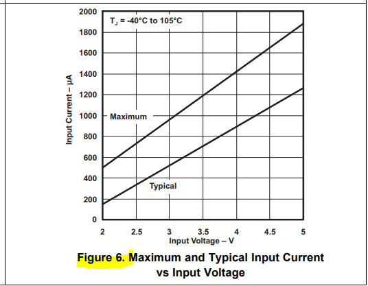

    You don't really need an extra series resistor if you can select VB as the part has built-in base resistor. Selecting base resistor is helpful if you can't tune VB. In that case you can either estimate the current by considering the VBE drop (base of NPN1 is ~1.4V higher than emitter by rule of thumb).
    A better option is you can use Figure 7 in the d/s. By knowing hFE at the output current need -> you get input current. From input current you need-> you get input voltage at the pin. From input current requirement + input voltage as a result of that current you can fine tune VB/RB_ext. If VB is fixed, then you can change RB os that VB-Vin(at pin) drop across your RB resistor gives you that input current you need.
    If you can tune VB , even easier, you can directly get the voltage you should apply to the input based on the figure you shared from d/s + this figure.
