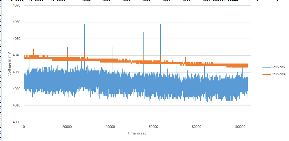

I know that there are some inaccuracies with the measurment of the cell 7 for the Lifetime-Data-Collection.
From this thread
I know that the measurement of the 7th could cause some gauging errors.

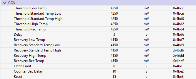

My question now is, can the inaccurate measurement of the 7th cell lead to safety problems, like a unintended triggering of Cell over voltage (COV), or something else?
