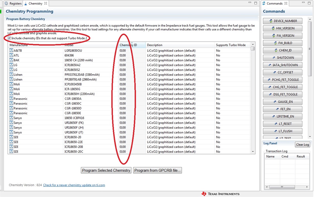

  • I don't know the cell model, but I know that one cell has a capacity of 1.7 Ah.
    There are 29 chemistry files with number 100 in the list. Please tell me how I can choose a file.
    And what does it mean that chemistry ID do not support Turbo Mode 2?

  • I mean these chemistry files with numbers 0100 ...
  • Hello Mihon,
    Select the ID that matches the manufacturer and ID of your battery, sine these are all for the 18650 type cell. I will double check with someone on the team to see which one would be best.
