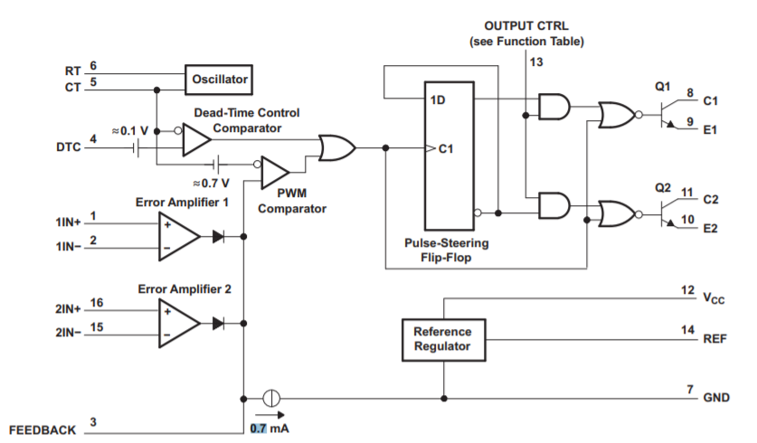

Why the TL494 need the 0.7mA
where the 0.7mA from
    When you design external feedback circuit and when that circuit connect to FB (pin 3), the circuit is required to provide up to 0.7mA to this pin so this pin can work normally. So the 0.7mA is from your external circuit which you need to design to meet this requirement.
