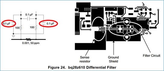

dear
The recommended capacity range is not found in the specification show as red logo in the picture. Is there a recommended capacitance range?thanks in advance
dear
Hi CS,
The circled caps are optional for additional noise filtering and if used should be 0.1uF.
Jason,
We don’t know if there will be damage. If you use a 0.1uF it will be ok, we cannot guarantee or deliberate anything outside these bounds.
