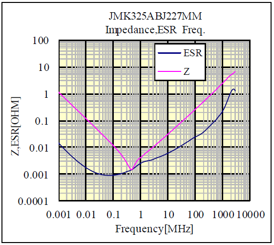

We have a problem with PTH08T240W. According to the datasheet, when RTT is short (0 Ohm), we need a high output capacitance (~2000uF). If we are using 2x100uF with ESR 5mOhm each, and 2200uF, than the module is not able to start, the output voltage is looks like the module is in short circuit protection. If I try just with 2200uF/6.3V low ESR electrolytic capacitor, the result is the same. The best result is when we are using a 220uF ceramic capacitor with 10mOhm ESR, but even in this case the module sometimes starts, than after 100ms switch off, than after 100ms switch ON again. The input voltage is 12V, the output is 2.5V, 1.6A.  With 2x100uF ceramic capacitor (5mOhm ESR) + 470uF (ESR 150mOhm) the module starts after 5-10 100ms cycle.

    I'm also trying to better understand the capacitance you are using in this testing. With RTT = 0Ω, it is required to have at least 1500µF Cout when using Type A, at least 1100 µF when using Type B, and at least 2000 µF when using Type C. Also, when using the PTH08T240W, there is a minimum ESR requirement of 7 mΩ. So when using turbo trans with the PTH08T240W, the allowed output capacitors is narrower than with the PTH08T241W.
    When using the 2x 100µF with 5mΩ + 470µF with 150mΩ, the effective ESR may be enough for stability with the combination but it doesn't meet the minimum output cap requirement for RTT = 0Ω. I think this combination would be similar to Type B output caps, so if you used 4x 100µF and 2x 470µF it may meet the stability requirements.
    When using 1x 220uF with 10mΩ, the effective ESR requirement is definitely met but again this isn't enough capacitance to meet the minimum output cap for RTT = 0Ω. If you used 5x of these caps it would satisfy the minimum ESR and the minimum cap.

    The https://ds.yuden.co.jp/TYCOMPAS/eu/detail?pn=JMK325ABJ227MM-P&u=M doesn't meet the minimum 7mΩ ESR requirement. Below image is the impedance and ESR vs Freq curve and it looks to be around 2mΩ ESR. For the ESR, use the ESR at the frequency where the ESR sets the impedance which is between 400-500 kHz for this capacitor. Below this frequency the capacitance sets the impedance and above this frequency the inductance sets the impedance. With low ESR ceramic caps like this, you would need to use the PTH08T241W instead to meet the stability requirements.
    What capacitor options do you have for modifying this design? If you would like to use only low ESR ceramics, the PTH08T241W should be used if that's an option. If you would like to use a mix of low ESR ceramics and higher ESR aluminum caps, you might be able to get combination to work with the PTH08T240W but you would need the majority of the output capacitance to come from the higher ESR caps.
