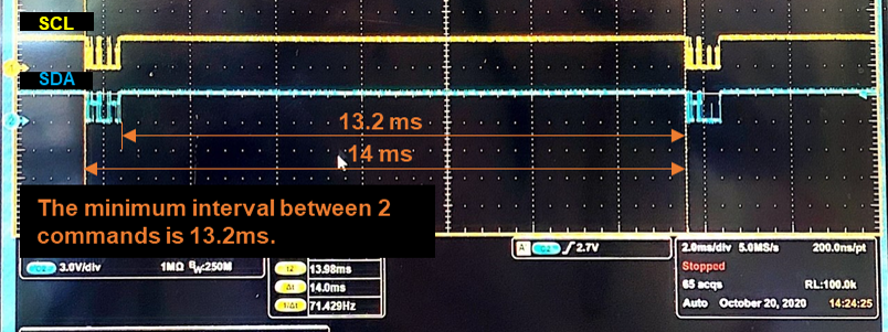

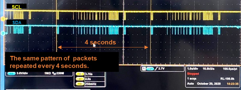

    I observed I2C communication of bq27421 EVM communication with bqStudio tool.
    The minimum interval between two different commands was 13.2ms, and a set of command packets repeated every 4 seconds.
    The observation result seems to match latter case, am I correct?

    bqStudio will read more packets, but in real operation, you don't need to log all the packets.
    The customer most likely will look at RSOC and perhaps voltage. That's where the recommendation on the TRM comes from.
