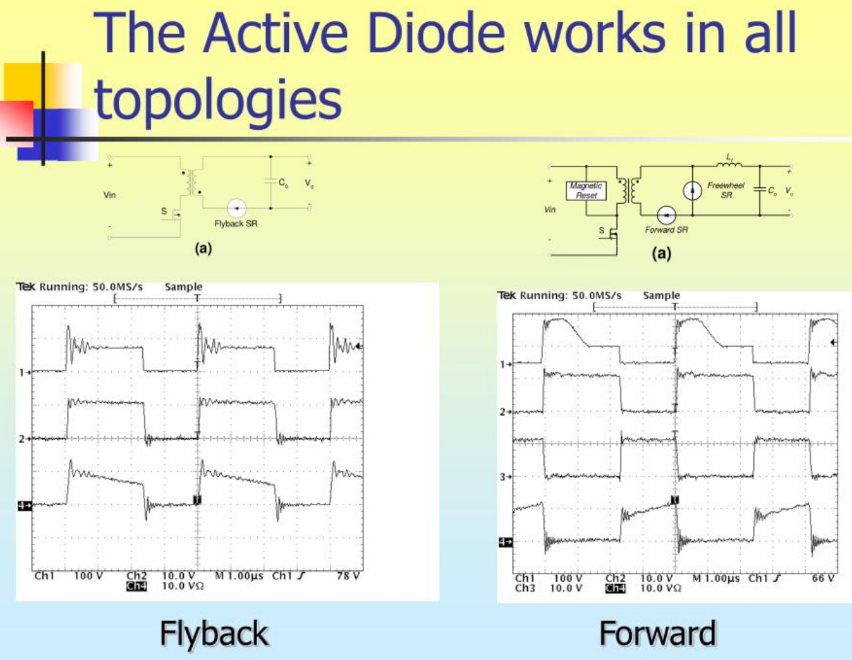

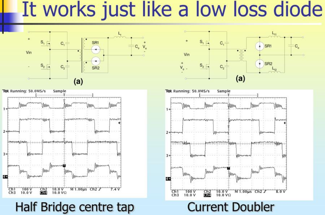

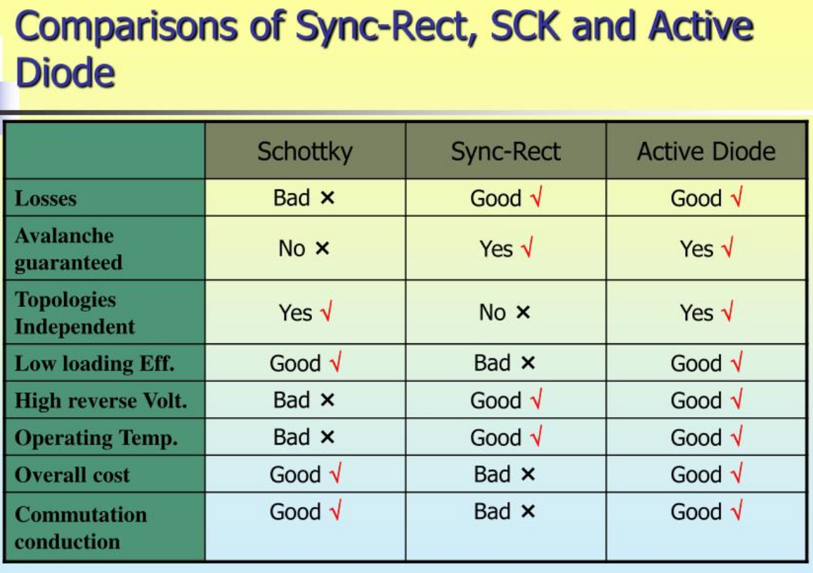

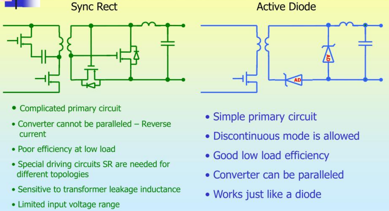

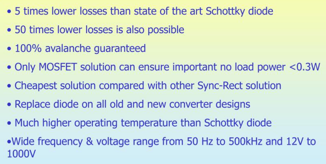

Can this device support Active Diode, as described in the presentation below?
https://www.slideserve.com/adina/the-active-diode-a-current-driven-synchronous-rectifier
This presentation claims the Active Diode will behave just like a diode, and works with any topology.
