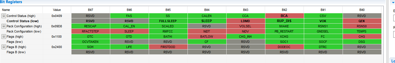

I would like to know if it is possible to check if the "IT_ENABLE" is active or not in bqStudio?
Hi
Hi Van,
Refer to 2.1.1.15 of the TRM:
https://www.ti.com/lit/ug/sluubw5/sluubw5.pdf
